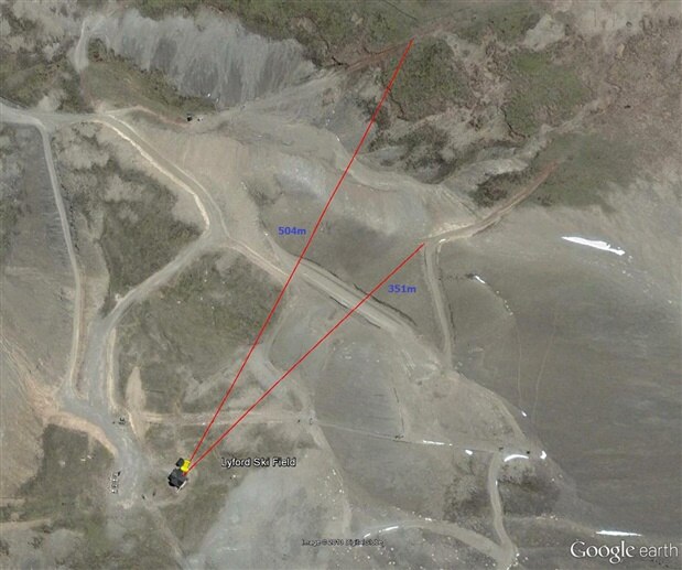

My solar powered  PiCamera installation took a step closer yesterday with the link options resolved.
Link
The WiFi link for transferring the data requires a directional antenna.
The Antenna design needs to be rugged to withstand the hostile environment, as well as the distances.
The links are 350-500m
(click on image for full size)

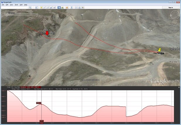

Google have some neat features that allow you to view the profile of the line. (Save the line, and then right click on it)
While the height reference data is not 100% it shows that the rise not far from the second camera shouldn't pose too many issues.
The real test will be when its covered in snow/ice as that may change.
Since we are only sending the odd image and a bit of data over the link, and its only 100Mbit Ethernet on the Pi, I'm certain bandwidth won't be an issue.

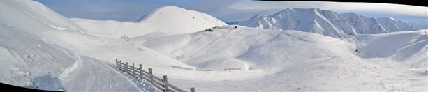

When the idea was first suggested, the idea was put a camera looking down the lift line to view the skiers coming up the tow.
A second camera would look back at the lodge (see below).
This  is roughly the view that is available, and was taken from the back of a  groomer, so is higher and wider than the Pi will deliver.
As we refined the concept and resolved that it was possible, the option to fit the first camera looking back at the lodge had more merit.
These included :-
  • Much easier access
  • Groomer has to pass daily so the panel could be checked/cleared
  • Shorter link path
  • Not subject to falling ice
  • Easier mounting
  • Doesn't require a lens to be fitted to PiCamera
  • Still visible to Cloudy Lift line for future data linking.
