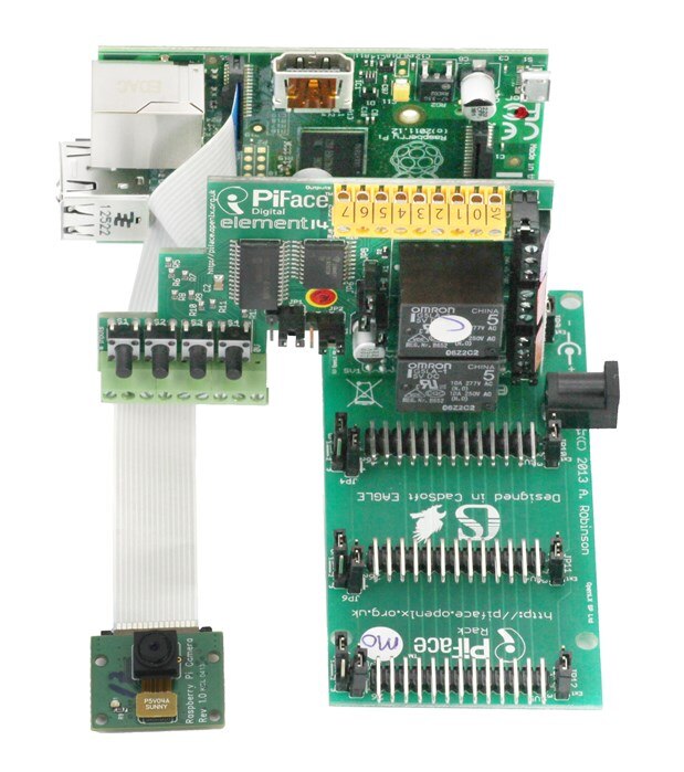

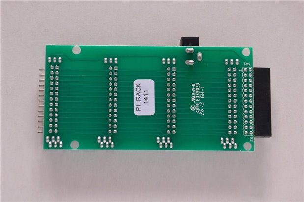

I was fortunate to get my hands on an early release of the PiFace PiRack. (I prefer to use the small i in the blog)
This has been mentioned in the PiFace documentation, but there was little other information.

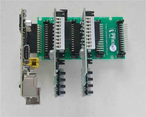

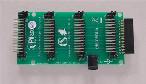

The PiRack is designed to extend the GPIO pins of the RPi (Raspberry Pi) out to a series of right angle headers, and an end connector.
You then stack 4 x PiFace Digital boards (or any other boards) onto the connectors.
A second PiRack fitted to the last connector gives the option of seven boards.
As the video explains, 7 boards gives 56 Inputs and 56 Outputs.
http://www.element14.com/community/videos/9290
To overcome the supply issues, the designer ( Dr Andrew Robinson )has fitted a DC jack to provide external power.
He also fitted jumpers to select the 5v source (external or from Pi) and allow the select lines to be jumpered to avoid two boards having the same address.

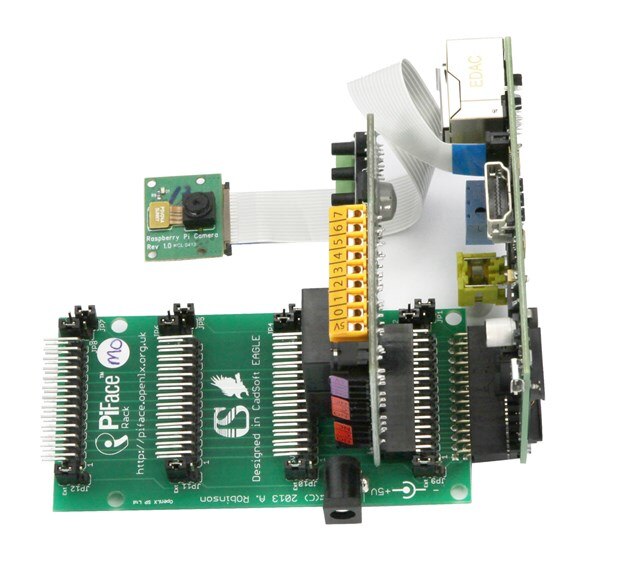

Photo from above the basic unit. Right side plugs into the Pi, while the left end is available for connections or another PiRack.
Bottom

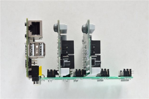

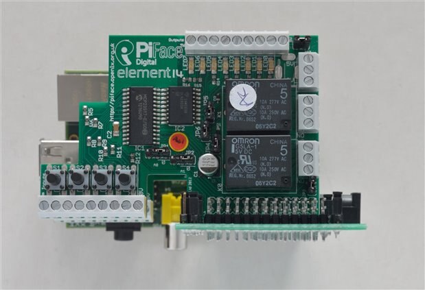

Photo of two PiFace Digitals fitted showing the clearance from the Pi, which allows the camera and other cables to be fitted.
Side view
End view showing Input cabling distance from baseline. Consideration when mounting should factor in cabling.
Two official photos showing the RPi with camera and PiFace Digital attached using the PiRack
Mounting
There are 4 mounting holes provided to secure the unit, however clearance for the Input cabling should be considered, as the photo above shows.
I'm not sure about permanently mounting the RPi or the PiFace Digital without some additional support that holds the boards at the correct spacing.
It is not good practice to use the connector as a sole means of support, as any flexing/movement is transferred back and results in the solder joint cracking.

The RPi comes with a GPIO that allows many other items to be connected, and unfortunately the PiFace Digital removed that while only using a few itself.
If you wanted to connect a temperature sensor that controlled one or more outputs, then you were out of luck, unless you fit two rows of connectors (see PiFace Digital )
Some items require power as well as the data pins (ie I2C LCD), so multiple devices can require some creative wiring in order to satisfy the hardware needs.
If you are still in the test or prototype phase this can be a hinderance or worse an accident that renders one or more parts to the scrap heap.
Using the PiRack gives 5 sets of the GPIO pins, and the option to power with an external 5v supply.
This would suit anyone contemplating servo control, as these generally cause issues with spikes on the 5v line.
As these come into use, I'm sure we will see some more creative uses that may or may not have been considered when first designed.

    jamodio over 13 years ago +1
    You should widen the pcb traces carrying power, they are too thin to reliably work as a power bus. My .02 Jorge
    shabaz over 13 years ago +1
    I suppose in theory this could be sliced if people want (say) just a couple of slots. EDIT: removed my comment about two RPIs - just realized why that isn't possible!
    mcb1 over 13 years ago in reply to jamodio +1
    Personally I think you are right. I would also have added some 0.1uF caps to ensure that 5v noise wasn't propogated. You could argue the supply does that, but its at the end of a long lead. It could also…

    I have a working Chicken Coop controller using the PiRack to stack boards.  Since the entire project uses a large number of 5V devices
    I use a single 5V supply and the 5V for the RPi is supplied by taking the top jumper of the Pi Rack and tying the three pins together and
    running 5V to that.  It has been working fine for months now.
  • wymand
    wymand over 12 years ago in reply to mcb1
    On page 7 of the PiFace manual it says it can either take power from or supply power to the Raspberry Pi 5V pin or can use an independent supply
