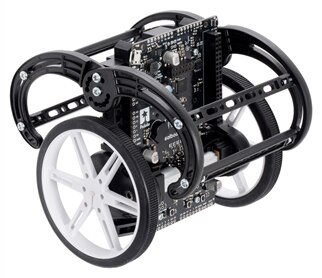

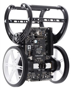

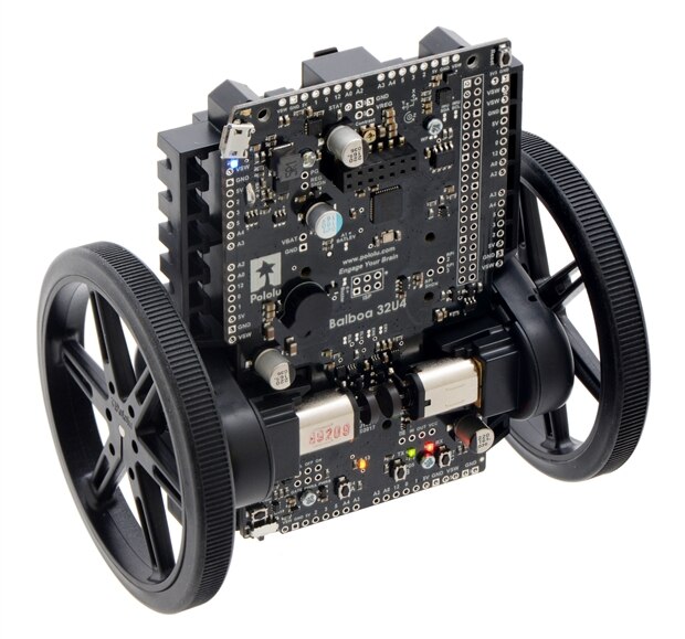

Assembly
The Assembly went relatively well.

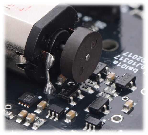

I would suggest tinning the motor connections before getting them anywhere near the control board.
There are a few SMD IC's right below the brush connections, and one solder blob is all it takes ....
I did have issues with the bearings and shafts.
Some of the bearings slide over the shaft, and others were so tight they required some persuasion.
So I would trial fit and juggle where to fit the tight bearings.
The assembly is not something that you could give to a small child without the possibility of damaging something.
There are various parts that would suit them, and others that are just too delicate.

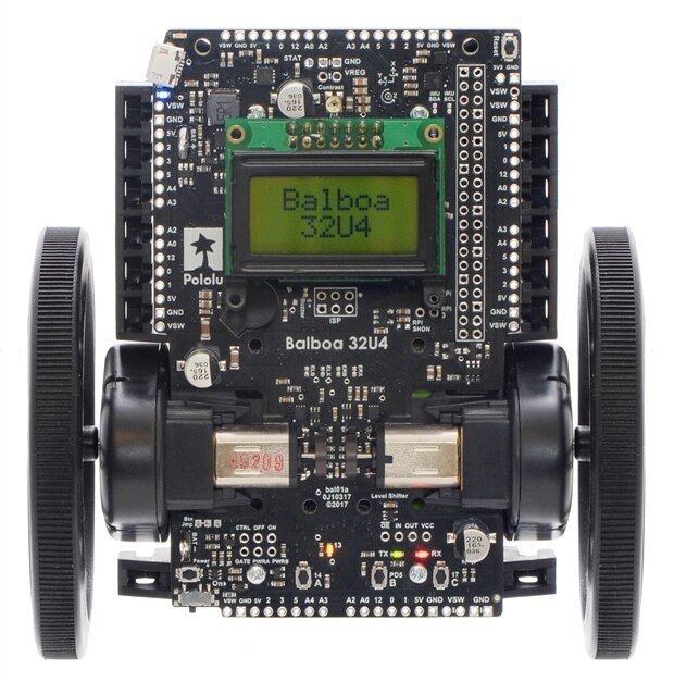

Controller

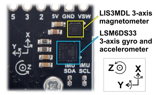

The Controller is based on an ATmega32U4 and the board includes the motor drivers, quadrature detectors, and various other interfaces.
It includes a LSM6DS33 gyro and accelerometer as well as a LIS3MDL 3 axis magnetometer.
They make the comment in the notes about interference and reference the forum on a solution.
https://forum.pololu.com/t/correcting-the-balboa-magnetometer/14315
I'm glad someone else has done the bits that make my head sore  image

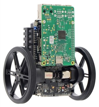

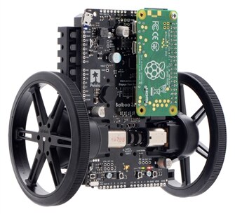

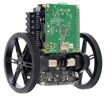

A Raspberry Pi header is provided and the 5v regulator capable of supplying 2A powers the RPi.
The integrated level converters allow connection to the I2C on the RPi.
They have even provided an 4096 byte ID EEPROM that connects to the Pi ID_SD and ID_SC pins.
I can see the Pi Zero being put to use later maybe.

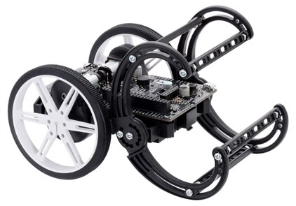

They provide some nifty arms to help prevent damage.
They are adjustable for angles, which is interesting given that it seems to be able to stand up from horizontal.
I've elected to keep mine closed, and it's close to zero degrees, so not sure how I managed that. image

I am going to chase down an 8x2 LCD as it should provide some useful feedback.

    mcb1 over 8 years ago in reply to fmilburn +3
    It only provides I2C connection between them, but there are other I/O on the Pololu controller that might interface to the RPi (level conversion required) was thinking the WiFI and maybe camera are options…
    was thinking the WiFI and maybe camera are options, but the RPi consume power, so you're shortening the run time .... by a lot.
