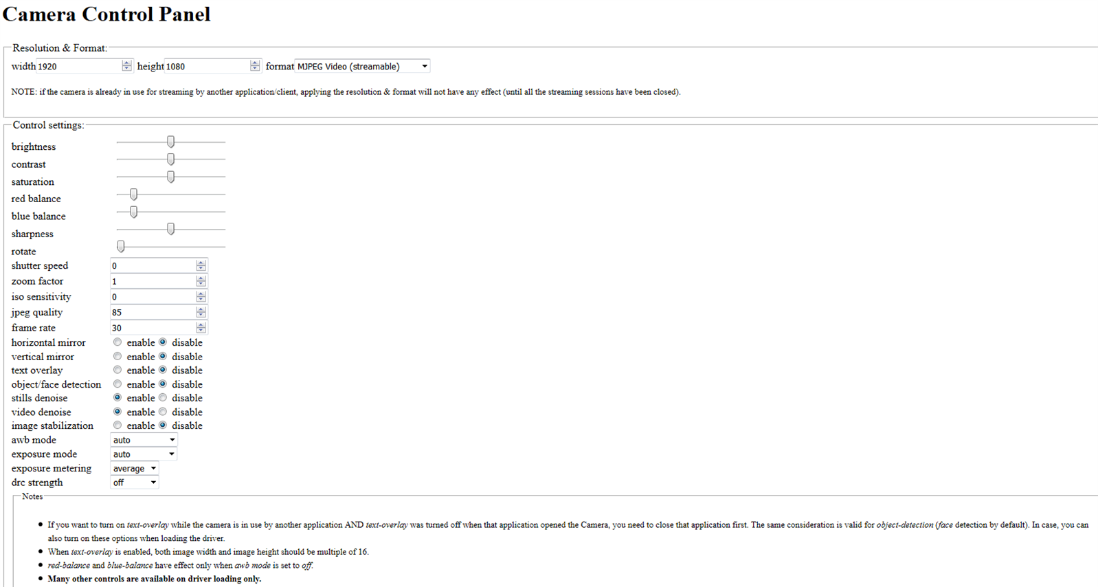

Google is a wonderful thing and I quickly found several links that demonstrated how to set up a streaming video that delivered to a browser.

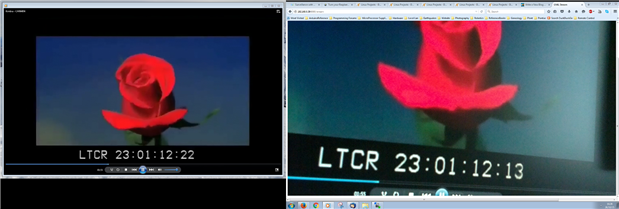

The first obstacle was the delay or lag.
The lag while a car is following is fine, but for reversing I decided that it's something to avoid.
The second thing was quality ... being able to note the registration number of the idiot behind you could be useful.
I finally arrived at this site     Linux Projects - Documentation
They use UV4L which allows a wide range of options and features.
Having installed it on a Pi2 and trying it with a video playing on the computer and over the ethernet connection the lag is minimal.
The configuration for this is
By my back of the envelope calculation 30 fps is about one every 33mS, so I might be two or three frames behind.
I have some more tweaking to do.
I certainly don't need HD, and a slight improvement to quality (it may be upscaling so I need to check the driver).
My first tweak to reduce the size to 1024x768 at 24 fps results in the stream simply stopping on a frame .... which is not very useful at the critical time.
