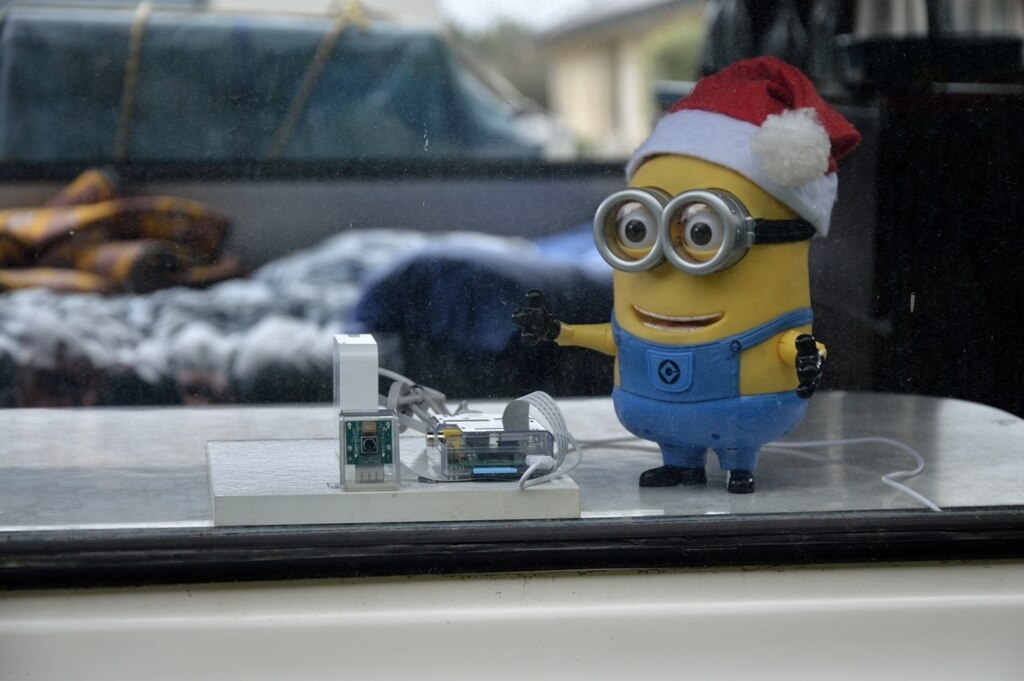

Back in 2015 I created a rear view camera for our caravan.
               Photo source Three Minions (me, myself and I)
Rear View Camera
While ver 1.0 was functional, it wasn't really useable for a number of reasons.
The height was fine, but it did require something to stop it moving around.

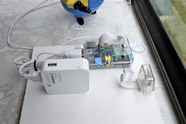

He knows I can't resist buying hardware for a rainy day, and so I brought one, and fitted the Pi Zero and camera into it.
2017
So fast forward to the end of 2017, and I decided that I'll use a PiZero and this for the Rear View Camera ver 2.0

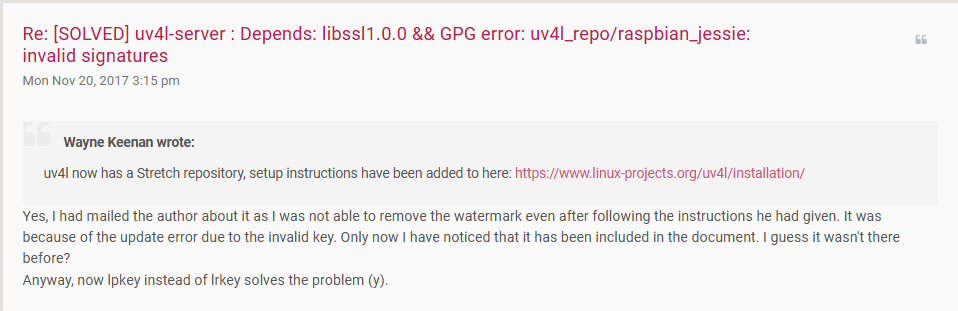

8.     You need to add a key. Type
curl http://www.linux-projects.org/listing/uv4l_repo/lpkey.asc | sudo apt-key add -
There is a discussion here about changing the lrkey to lpkey for Stretch  https://www.raspberrypi.org/forums/viewtopic.php?t=194608

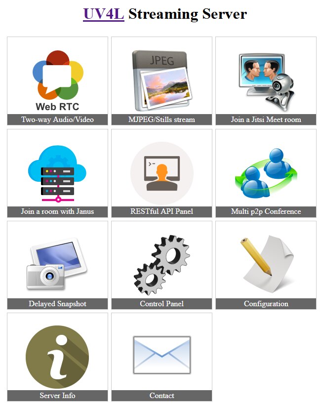

Webpage
The UV4L-Server you added provides a webapge at <PiZero IP Address>:8080

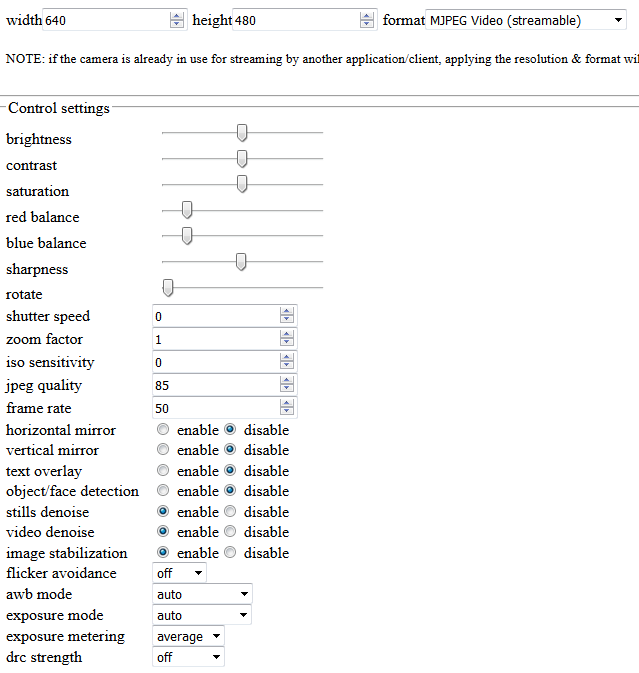

Control Panel is the first place you should head to tweak the settings.
For my purpose I reduced the size and increased the frame rate
Click on the Apply button at the bottom and it will apply those settings (provided you aren't streaming)
If you click on
you'll see a streaming video.
