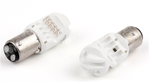

The second model was easier as they were using these LED lamps which included the necessary dimming for the tailight.
I've since found them here Philips Red Led Brake Lights S25 P21/5W 1157 BAY15D 12836 2 Dual Brightness
I was very impressed with the lamps, as most of the retrofit LED's are rather 'feral' in their design, while these look properly engineered to provide proper light distribution.

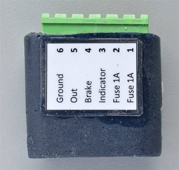

So I made version 2.0 of the modules and this time I added a fuse and encased them in resin to provide protection. (and prying eyes)
I'll find out this weekend how they went, but I suspect I'd hear if they weren't working.
Set number 3 were offered to a local Hotrodder, as he struggled with the wiring and then hit the issue with combining tail/brake and indicator into a twin filament lamp.
His budget didn't extend to an automotive electrician and relays or whatever they would suggest (no-one else offered a solution).
We came to an arrangement where he provided some of these stickers
and I made him some modules
I had built the units and tested them before delivering them, but last week after the LED lamps arrived, I got a phone call and he was having some issues.

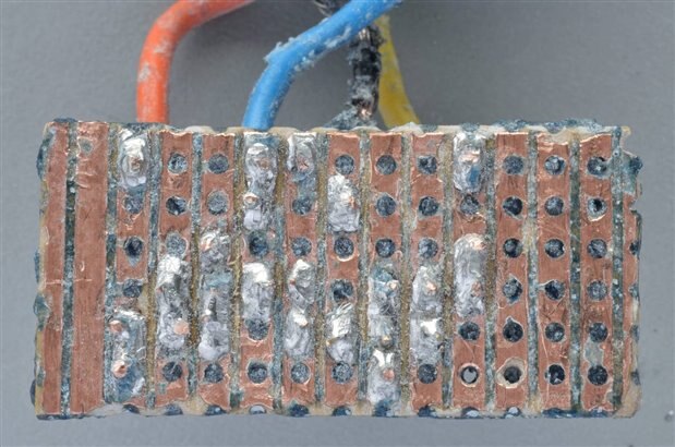

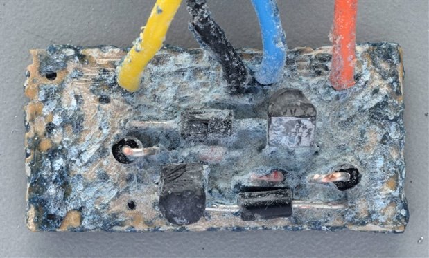

In the interests of good engineering, it's always useful to know what failed and see if you can determine why.
However these were encased in resin, and worse, it was coloured so the exact placement of the parts was invisible.
Several hours later with a Dremel and different tips exposed enough of the internals to do some testing.
Since there are three different components that could be at fault, I was trying to be careful and not damage the components.
I've always found that you need to be able to replicate the fault, in order to prove you've fixed it.
I was able to replicate the fault before attacking it, and again when exposed, so my work didn't cause a second issue.  ... image
Fault identification
I can really only get to the bottom of the board which is enough to verify what I suspect is the problem.
Thankfully jw0752 had sent me some of his Intrusive Meter Probes to test.
Meter Lead - JW special probes
These were able to penetrate the resin that was still on the veroboard and ensured the meter made good contact with the components.
While the unit has failed, the exact cause will never be truly known.
It could have been a wiring mistake in the vehicle that got rectified, or something else.
With the complexity of the wiring and the admission that vehicle wiring is not something he is confident with, it's possible there was a problem.
I'm not concerned if the fault was due to a mistake, but it would be nice to know that.

    mcb1 over 8 years ago
    I forgot to update this.
    It seems that one unit was destroyed or it failed on it's own and the tear down proved that.
    The two new units cast much better, and tested just fine.
    I arranged to visit and help see they worked correctly.
    I fixed a couple of minor wiring issues that weren't incorrect, it's just that they might fail later.
    When we tried the units, they also behaved strangely and worked with just the brake, or just the indicator.
    After heading into some rabbit holes, the owner said he had the wiring diagram for the indicator unit somewhere and dug it out.
    Once I looked at it carefully, I noted that it had the ability to feed the brake signal into it.
    I hadn't realised it was from the USA and had the ability to combine brake and indicator into a lamp, but used a different flasher unit (one I've never seen here in NZ)
    Once we removed the brake feed into the indicator unit, the whole thing worked properly !.
    What a relief for both of us.
    So it's always surprising what is going to bite you, and the 'never give up' attitude certainly wins .... eventually.
    It also explains why I couldn't prove the fault on the bench, I wasn't simulating the exact conditions found in the vehicle.
    We also added the necessary extra piece I'd built so the indicator stork flashes when they are operated.
    The result was a very happy owner.
