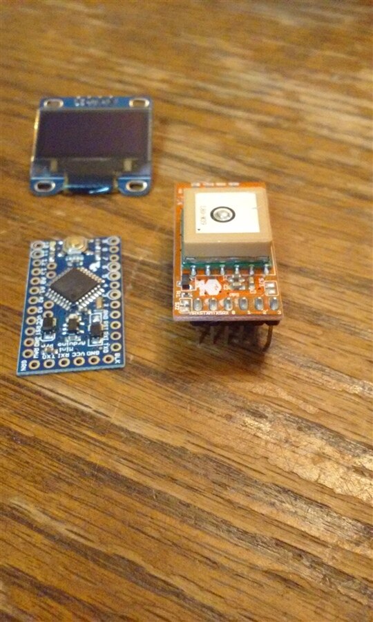

The hardware
I have two options I am considering.  Both use the Microstack GPS.
Option 1
I plan to use an Arduino Pro Mini Clone.  I have found a version that at $1.85USD it works perfectly.
I will also use an monochrome OLED.  This is a 120X96 resolution.
I'll need a few tactile buttons.
I'll need a 3.3V and 5V regulator, and I chose the AMS1117 linear regulator in both voltages.
Option 2
I have a clone TFT LCD clone that costs mea few $.  It needs an Arduino UNO to function, as it is in the form of a
shield.  This Screen also has a SD card which is nice for storing GPS data.
I wont need any buttons as it is a touch screen.  I will still need a 3.3V regulator for the GPS unless I decide to
use the one onboard the UNO.

Option 1
Weight is < 1/2 oz.
Total cost (rounded):
PartCost (USD)
Arduino Mini (5V)$2
GPS$25
OLED$4
AMS1117 (3.3V)$.10
AMS1117 (5V)$.10
MISC$5
Total$37-$40

To parse the  NMEA sentences coming out of the GPS, it is a trivial task to use the TinyGPS++ library.  This
library uses the Serial Port to read the GPS.  This is perfect since the Microstack GPS unit uses the serial port
as well to send data.  I feel that a frequency of 2HZ will be suffice for logging speed.  The 16MHZ Arduino should
be able to handle this incoming data at 57600 bps.  Any faster and I fear it may bog the Arduino down.
I do not plan at this time to log any GPS coordinates but simply keep track of the last highest speed and altitude.
I will use the EEPROM memory to store last values for viewing after a power cycle.
The user interface via the TFT or the tactile buttons is simple.  I need the ability to reset the values for a new speed
run.  I may add an option to turn the screen off and on as well, no need to have it update while in the aircraft.
A couple of status LEDs will also be used to indicate what is happening so I can see that it is working even with
the screen off.  The Microstack GPS also has an LED to indicate everytime it does a fix.
