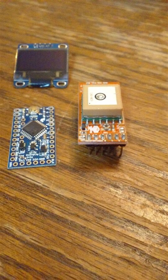

I have two options I am considering.  Both use the Microstack GPS.
Option 1
I plan to use an Arduino Pro Mini Clone.  I have found a version that at $1.85USD it works perfectly.
I will also use an monochrome OLED.  This is a 120X96 resolution.
I'll need a few tactile buttons.
I'll need a 3.3V and 5V regulator, and I chose the AMS1117 linear regulator in both voltages.

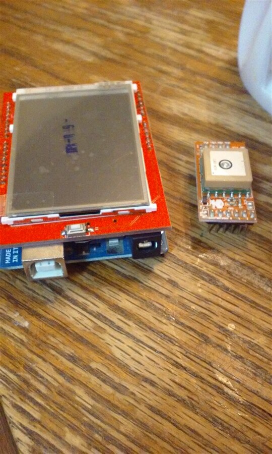

Option 2
I have a clone TFT LCD clone that costs mea few $.  It needs an Arduino UNO to function, as it is in the form of a
shield.  This Screen also has a SD card which is nice for storing GPS data.
I wont need any buttons as it is a touch screen.  I will still need a 3.3V regulator for the GPS unless I decide to
use the one onboard the UNO.
Comparison

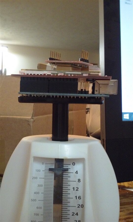

Option 1
Weight is < 1/2 oz.
Total cost (rounded):
PartCost (USD)
Arduino Mini (5V)$2
GPS$25
OLED$4
AMS1117 (3.3V)$.10
AMS1117 (5V)$.10
MISC$5
Total$37-$40

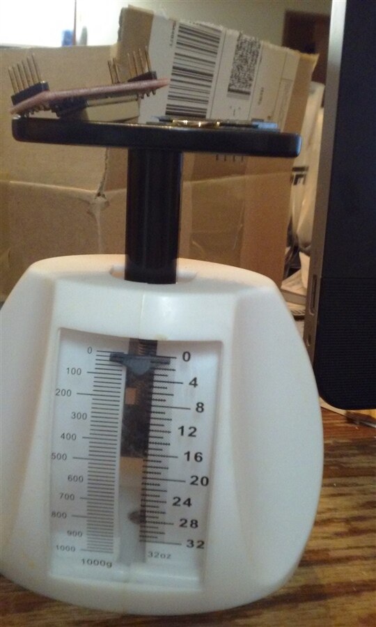

Option 2
Weight is about 2 oz
PartCost (USD)
Arduino UNO$10
GPS$25
TFT LCD$5
AMS1117 (3.3V)$.10
AMS1117 (5V)$.10
Misc$5
Total$45-$48

For the LCD, you know me, I bought a Chinese knockoff from Ebay.  I got 2 of them.  I used the Adafruit drivers and
of course they didn't work.  I managed to get the demo working by hardcoding the device ID, for some reason it
cannot detect it.  For the Touchscreen, it doesn't get the coordinates right so some fixing there will be required.
The 2nd screen I have the touchscreen doesnt even work!
The question is which option is better?  Option 1 is lighter so it can be used for smaller aircraft, though I am
not sure I would have a desire to measure speed.  Option 2 just seems more modern with the cell phones and tablets
we have these days.  It certainly would be more snazzy.
