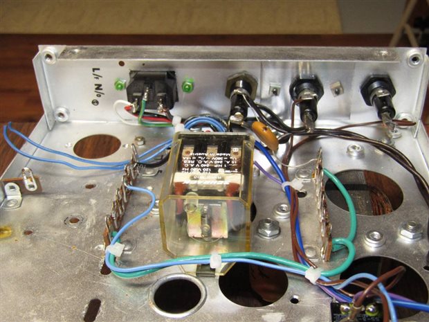

Once I had the primary components on the chassis I began to populate the unit with minor components and finally I began the initial wiring.
In this picture you can see the fuses for the primary, secondary and output circuits that were recommended by my element 14 collaborators as well as an AC relay that will be used in the circuit that will prevent the unit from being turned on if the variac is not in the low voltage position. In the lower right corner of the picture you can see the microswitch , better picture to the right, that senses the zero volt position of the variac. When the wiper of the variac comes to the full off position a small epoxy ramp on top of it actuates the microswitch. If this switch or the override switch is not closed the relay will not actuate and latch. When I installed the microswitch it was necessary to cut slots for the mounting screws so that the position relative to the variac wiper could be adjusted.
