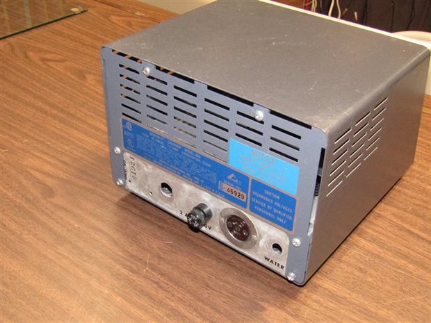

As usual I began this project with a slow trip through my parts graveyard looking for resources. I almost never produce a design and then look for the parts. It is always find the parts and then design an interface between them. The central parts central to the build were a transformer, where 115 VAC on the primary would give me an isolated 130 VAC on the secondary, a small variac, and a salvaged case from a piece of 1960s vintage dental equipment.
Here are the transformer and the variac in the early proof of concept experiments. It is important to bread board or jumper wire experiments of the build before proceeding so that one will eventually get the desired results.
The case was hopefully going to be big enough to house everything. It was a heavy steel case with an old fashioned chassis inside. The chassis would have to be substantially modified before it would properly hold the components. I began by spray painting the case a nice off white color. The front panel was a piece of black opaque plexiglass. I have used this type of front panel on many of my builds as it is easy to work with and when labeled with white on clear label tape it looks good enough for me.
Here is the painted case and to the left is the chassis where I have mounted the isolation transformer and the variac. For the variac I had to cut the floor of the chassis and fold it up to make an extension of the front metal. This made room for the body of the variac as well as providing extra support for the front plate. As the project continued this was the first of several cuts and bends that needed to be done to the chassis. In the front left you can see the preliminary layout of the front panel. At this time the front panel meters had not come and so I had estimated their dimensions. Time would prove that I had greatly underestimated their size and many of the challenges to finishing this project revolved around how to integrate them into the case. Eventually I had to cut more of the front of the chassis out and extend the square hole that you can see in this picture to the left, almost all the way to the variac plate.
