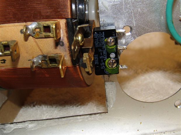

In this picture you can see the fuses for the primary, secondary and output circuits that were recommended by my element 14 collaborators as well as an AC relay that will be used in the circuit that will prevent the unit from being turned on if the variac is not in the low voltage position. In the lower right corner of the picture you can see the microswitch , better picture to the right, that senses the zero volt position of the variac. When the wiper of the variac comes to the full off position a small epoxy ramp on top of it actuates the microswitch. If this switch or the override switch is not closed the relay will not actuate and latch. When I installed the microswitch it was necessary to cut slots for the mounting screws so that the position relative to the variac wiper could be adjusted.

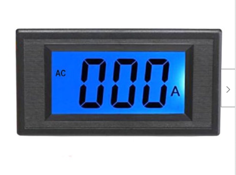

Here is a picture of the ammeter. The larger size forced me to return to the plan for the front panel and begin searching for every millimeter of space. The front panel on which they were to be mounted had conflicts with the chassis and there was the ultimate need for everything to fit inside the bezel of the outer case. It was very close and don't tell anyone but in the end the fit inside the bezel of the outer case is not perfect. Fortunately the black plastic panel hides the slight gap very well.
Another challenge that I left for the arrival of the meters was the fact that the ammeter was designed to measure up to 100 amps and the most I anticipated measuring was 3 amps. This would mean that I would not be making good use of the range of the ammeter and that my current measurement accuracy would suffer. The ammeter came with a huge current transformer.
Here you can see the current transformer mounted to the chassis. Fortunately once I got away from the crowded front panel there was lots of room in the body of the unit. I decided that I would put two windings on the current transformer and install a SPDT toggle next to the ammeter so that I could choose between the single 0 to 100 amp display on the meter to a more detailed 0 to 10 amp display. As you can see on the right side of the current transformer I have wound the current carrying conductor 10 times to produce the compressed range. On the left side of the transformer we have the single pass through of the 0 to 100 range. I experimented briefly with moving the decimal point on the meter but total lack of technical information made this a difficult and risky modification. In the end I decided to make use of a unit of current that is seldom encountered. "The Deciamp". Yes, when the toggle is switched to the 0 to 10 amp range the meter displays the current in deciamps. While not totally desirable it adds some character to the unit and it is worth the extra accuracy that is displayed by the meter. These meters were quite inexpensive, less than $15 each and while they work well for this application they take their time reading and displaying the voltage and current. I think they refresh twice a second and the 1 to 100 amp range will sometimes take 3 to 4 seconds to settle on the correct display. In the short video at the end of this blog you will see when I switch from 4.6 deciamps to amps the display reads 2 then 3 and while I don't wait for it to get there it will eventually display 4.

    By the look of the current transformer, it looks like it is a unit for use on busbars in electrical panels, the shape of the central hole is designed to accept cables or square / rectangular bus-bars.
    If you can find out its ratio, then you could replace it with a more suitable unit to give you better resolution on the ammeter, if you felt like it. Industry standards are 1A or 5A secondaries, so if it is one those it would be relatively easy to source something, if it is a more unique rating then you will probably be best to leave it as you have it.

    jw0752 over 6 years ago in reply to three-phase
    Hi Ralph,
    The transformer has a 5A secondary. Does this mean I can substitute a 10A primary with a 5 amp secondary and not have to recalibrate the meter?

    three-phase over 6 years ago in reply to jw0752
    No, I do not believe it would save you from having to adjust the ammeter itself. The input of the ammeter is 5A and has been calibrated to convert that 5A into a 100A reading. Thinking about this, if the CT ratio is changed from 100/5A to 10/5A, it will just mean that you will only need 10A primary current to read full scale, which will still be 100A. You have effectively achieved this by wrapping the 10 turns around the CT.
    Besides, looking at the price of these meters, they are less than a 10/5A CT.
