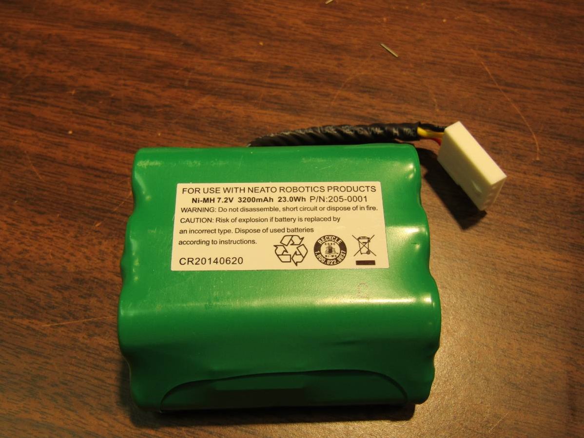

It occurred to me that this gear pump would be perfect for pumping cream from a modern plastic tube. The pump was sold as a 12 Volt pump but experiments have shown that this is way too much power. Optimal voltage for pumping the cream turned out to be between 1 and 2 volts drawing 3 amps. My initial idea was to use AA batteries to supply the power but at the draw of 3 amps this would not be practical. I had some high capacity NiMH 7.2 volt packs that had been used in a Neato Robotic vacuum cleaner. I also had a nifty little 10 Amp variable DC to DC converter that I bought on one of my binges on a Chinese electronics site a while ago. The batteries had been capable of running the Vacuum for about an hour before they had to be charged. Even at 3 Amps for each squirt of cream they should last several tubes of pain cream before they need to be recharged.
Here is the battery pack that will be used:

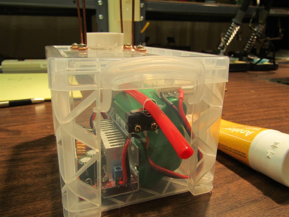

Here is a picture of the device under construction:
The inlet of the pump is a metal needle sticking out of the white plastic and the outlet will be through the red polyurethane hose. The red tubing will exit the box though an oblong hole in the case and rest on top of a small SPST micro switch. The idea is that a slight downward push on the tubing will activate the switch and turn on the motor. Below is a better picture of the tubing exiting the box.
