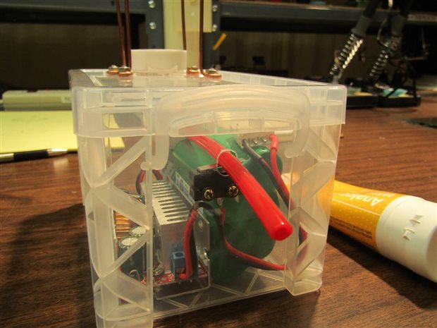

It occurred to me that this gear pump would be perfect for pumping cream from a modern plastic tube. The pump was sold as a 12 Volt pump but experiments have shown that this is way too much power. Optimal voltage for pumping the cream turned out to be between 1 and 2 volts drawing 3 amps. My initial idea was to use AA batteries to supply the power but at the draw of 3 amps this would not be practical. I had some high capacity NiMH 7.2 volt packs that had been used in a Neato Robotic vacuum cleaner. I also had a nifty little 10 Amp variable DC to DC converter that I bought on one of my binges on a Chinese electronics site a while ago. The batteries had been capable of running the Vacuum for about an hour before they had to be charged. Even at 3 Amps for each squirt of cream they should last several tubes of pain cream before they need to be recharged.

The inlet of the pump is a metal needle sticking out of the white plastic and the outlet will be through the red polyurethane hose. The red tubing will exit the box though an oblong hole in the case and rest on top of a small SPST micro switch. The idea is that a slight downward push on the tubing will activate the switch and turn on the motor. Below is a better picture of the tubing exiting the box.

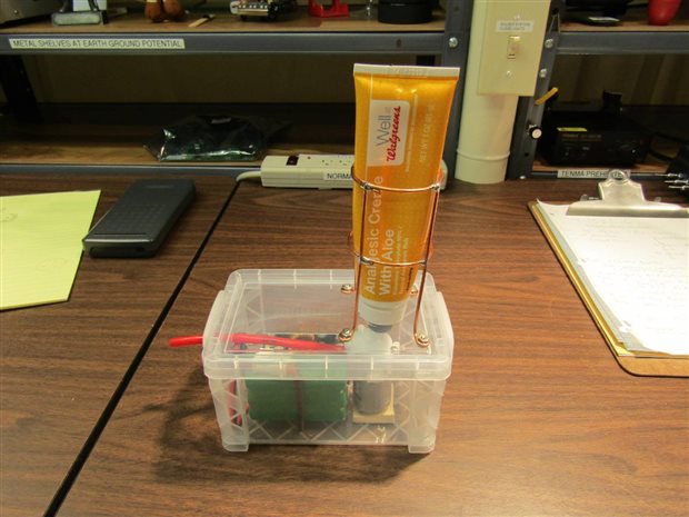

Since this device is more electrical than electronic I have not produce a schematic for it. The design was more or less dictated by the resources that I had available to build it. I decided to construct a protective cage around the pain cream tube which sticks up from the top of the unit. This will prevent too much stress being placed on the adapter cap which is mounted to the top of the box. Here are pictures of the cage without and with the pain cream tube installed.

    Hi Spanner,
    Thanks for your post. The gear pump seems to thrive on a slightly thicker medium as it helps seal any back flow. Actually this little pump has good enough tolerances that it will create a slight self priming vacuum. The little gear pump is really quite unique. I remember years ago gear pumps were used for oil circulation in automobile engines and driven off the same shaft that turned the distributor. I have been out of touch with auto technology for many years now so I do not know if they are still being used. Thank you for your offer of parts if I decide to build a MK. II. I will have to wait for Mom to test the present unit and then make a determination if I can make some improvements.
