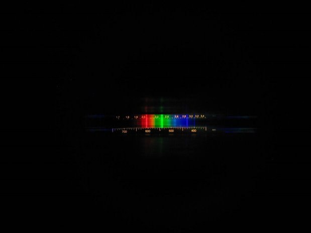

I volunteered to try to capture the spectrums of some of the common LEDs. The discussion in that thread had been about the effectiveness of LEDs as grow lights for the Vertical Farming Challenge. I have a cheap spectroscope that I got to show the grandkids about how we can know the elemental composition of things by looking at their spectra. The poor quality of my results made me decide to present the pictures as a separate Blog so that I wouldn't mess up the other discussion . I have reference the other discussion above and I will cross reference this one in that thread.
There were a couple strikes against me from the start as the spectroscope was cheap and my camera was never designed to take pictures in a spectroscope.
Here is a picture of the bright line spectrum of a fluorescent light taking after 20 picture and 2 hours of experiments.
Notice the bright green line at 546 nm. This line is from the Mercury in the fluorescent tube. My hope was to get images like this of the light from different color LEDs but that wasn't to be.

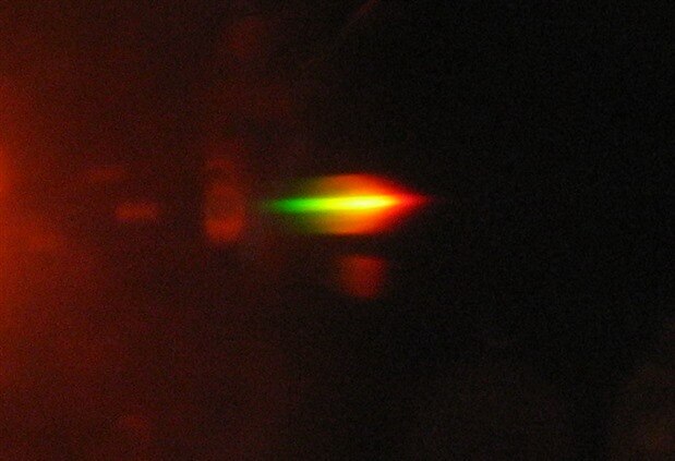

I fell back on plan "B" and used a diffraction grating in front of the different color LEDS and photographed the spectrums created on the grating.

I next chose an Amber colored LED and this time we get a few colors in our spectrum.

Other than a curiosity this information will be of little help in the Vertical Farm Project. I was surprised that the LEDs that I tried had as much spectral spread as they did. I really expected a much narrower band of light.
    shabaz over 11 years ago +3
    I'm impressed it was able to resolve the amber and green LEDs to quite some detail - more than the datasheet reveals I bet. And examination of your camera image would probably help with intensity measurements…
