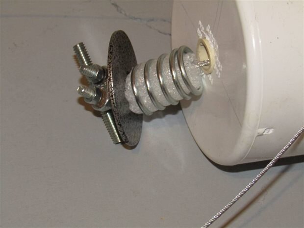

After several failed attempts a longer lever arm was added which reduced the force needed. I wanted to use gravity to move the lever. Gravity would supply a steady force as the valve is rotated in contrast to the non-linear force supplied by a spring. Thin steel cable was attached to the end of the lever arm and run up to the ceiling and through a pulley and then attached to a weight made of PVC pipe. The PVC was filled with stones until the desired weight of approximately 6 kg was obtained.
The PVC weight was constructed so that a smaller internal piece of PVC ran the length of the weight. The wire cable was threaded through the center pipe and secured at the bottom as indicated in the picture. A spring shock absorber was fabricated at the bottom to minimize the impulse force to the valve as it hits its stop position.
