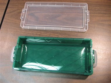

The physical construction of the unit begins with finding a project box. For this unit I chose one of my favorites, a plastic Pencil Box sold by Advantus Corp of Jacksonville, Florida.
http://shopadvantus.com/shop/pc/showsearchresults.asp?pageStyle=H&resultCnt=20&keyword=Pencil+Box&ctl00%24ctl03%24imbGo.x=0&ctl00%24ctl03%24imbGo.y=0
I like working with the plastic and they usually look presentable when finished. I use a diamond bur in a high speed drehmel to cut the holes that I need in the plastic. Experience has shown that drilling with a standard bit almost always results in cracking the plastic. For this project I used a totally clear plastic box. Here is a picture of the assembly of the mechanical parts under way.
