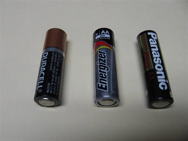

For the actual test I chose the 2 major brands of battery E**** and D**** as well as a Panasonic battery that I purchased in a 3 pack at the local Dollar Store. The cost break down was Brand E**** $1.20, Brand D**** $1.20 and Panasonic $0.33.  Since my old camera calls for new batteries whenever they drop below 1.4 volts I decided the first leg of the test would be from New out of the package to 1.4 volts with a 250 mA load. This first test was followed by a second test where the load was increased to 500 mA and then timing the battery until it reached 1 volt. The results of these two experiments are summarized below.

Disclaimer: This battery test was conducted with loose controls and non-precision equipment so the results are perhaps anecdotal at best. For this test “AA” batteries were chosen. The Name Brand  batteries, D**** and E**** that were tested were purchased new at a reputable retail outlet for $4.79 for 4 batteries and were dated 2014 with a guaranteed shelf life of 10 years. The Panasonic Batteries were purchased at The Dollar Store paying $1.00 for 3 batteries. The Panasonic Batteries were not dated but also guaranteed the shelf life to be 10 years. The E**** battery weighs 23.6 grams, the D**** battery weighs 24.1 grams, and the Panasonic battery weighs 23.0 grams.

In the range of brand new to 1.4 volts at 250 mA all three batteries had similar performance. If 1.4 volts is considered the low level point then time wise we would rank the batteries:
#1 D*** with 22 minutes of usable power.  ( 0.092 Ah)
#2 E*** with 20 minutes of usable power. ( 0.083 Ah)
#3 PANA with 19 minutes of usable power. ( 0.079 Ah)
Reevaluating with cost as a factor we obtain:
#1 PANA with $4.18 per Ah
#2 D*** with $13.04 per Ah
#3 E*** with $14.46 per Ah
In the range of 1.4 volts to 1 volt at 500 mA I found the bulk of the power stored in each battery. This test demonstrates that a lot of battery potential is being thrown away when equipment is unable to tolerate battery levels down to 1 volt. Here is the battery ranking in this range.
#1 D*** with 2 hours of usable power. ( 1.0 Ah )
#2 E*** with 1 hour 45 minutes of usable power. ( 0.875 Ah )
#3 PANA with 1 Hour 40 minutes of usable power. ( 0.833 Ah )
I will now integrate the two test runs and calculate the cost per Ah for each battery:
#1 PANA with 0.912 Ah of power between new and 1 volt costs $0.36 per Ah.
#2 D*** with 1.092 Ah of power between new and 1 volt costs $1.10 per Ah.
#3 E*** with 0.916 Ah of power between new and 1 volt costs $1.31 per Ah.
I can’t speak for anyone else but if you can find an alkaline battery in a discount store that can supply 84 % of the power of a top name brand at 28% of the cost of the same name brand I would call it a no-brainer.
