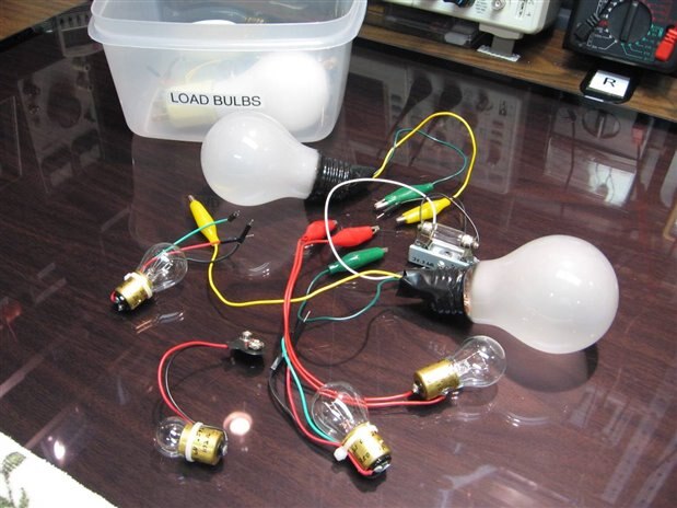

In January of this year, inspired by some of Robert Peter Oakes 's excellent tutorials I decided to begin to design and construct a DC load. I have been learning and improving my electronics ever since joining E-14 about two years ago. Those of you who are familiar with me know that I tend to be a little retro and basic in my approach to problems and projects. This DC Load unit which I have dubbed " La Carga " (named chosen by 4ringfan) will be no exception. Up until now I have always been satisfied to grab what I called a "LOAD BULB" every time I wanted to load a circuit.
While these have served my needs in simple experiments the progress of the last couple years has put me in a position where I want a little more precision and control of the load in my experiments.
