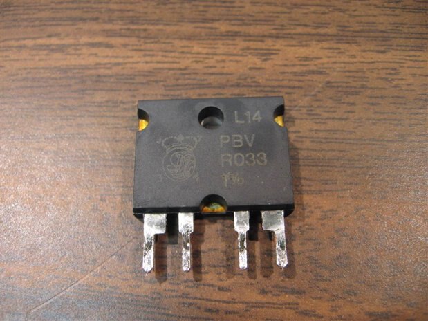

Today I salvaged out a circuit board from an ESPE Dental Cure light. To my delight there was Kelvin precision resistor on the board. Specifically it was an Isotek PBV R033 which is a heat sink mounted 10 Watt Kelvin resistor with a value of 0.033 Ohms 1%. Here are front and back photos of the device. I first learned about these resistors a couple years ago from one of the great tutorials posted by Robert Peter Oakes on building power supplies.
Now in the big scheme of things the arrival of a real 4 terminal Kelvin resistor to my bench must seem pretty trivial but this is my first. Yes in 55 + years of tearing equipment and circuit boards apart this is the first time I have had a Kelvin Resistor to test out. What follows is an exercise in simplicity but it is the type of experiment that must be performed on the occasion when something new shows up. In case you would like more information on this particular resistor here is a link to the company data sheet:

    jw0752 over 10 years ago in reply to shabaz
    Hi Shabaz,
    At first glance I too thought it was a bridge. When it lacked the common + , _ , and AC symbols I checked further. I also noticed that the inner legs of the device were smaller than the outer. A short search for the part number on the web told me it was a Kelvin resistor and gave me a big smile.
