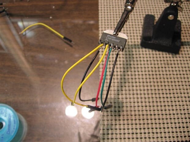

Here is a closer look at the component still mounted to the board.
The salvage of the component from the board was a bit of a challenge. Caution has to be taken not to damage the part and with eleven legs to remove it does not cooperate. In this case I tried to use the heat gun to melt all the solder points at the same time but there was too much heat dissipation in the component. Next I tried to heat and solder vacuum the individual legs. This removed most of the solder but still not enough. My next approach was to put the solder back on the front legs and lift them one at a time as I heated the solder with the iron from the back side of the board. Once the front legs were free I went to work on the 5 back legs and finally was able to free the component. Now that I had the proper technique down the second LMD 18200 came out more easily. In a couple instances, in the past, I have gone so far as to cut the board with a drehmel so that the individual pads could be removed from a desirable component. Fortunately this wasn't necessary this time.
After the chip was free I soldered bread board wires to each of the eleven legs and attached the IC to a piece of aluminum so I would not have to worry about heat during my experiment.
