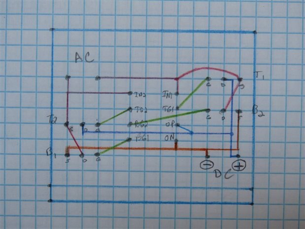

    I wasn't very happy with the breadboard of the LT4320 Ideal Bridge circuit. The jumper wires that I used added a resistance variable that did not allow me to get a good comparison with the regular diode bridge. Therefore I decided to put together a prototype circuit on perf board and solder the connections and jumpers. After three attempts to lay out the components I settled on this layout:

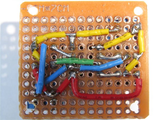

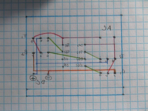

    The graph paper represents holes of the perf board. Since this is a top view I took a picture in a mirror to produce a bottom view as this is the side I would have to solder the connections to.
    Except for a position shift in all the MOSFETs to better use the space and better align with the gate output pins of the IC  I proceeded to solder up the board as drawn. I made an attempt to color coordinate the nodes. The green jumper was the only gate output to it corresponding MOSFET that wasn't tied directly to the IC.

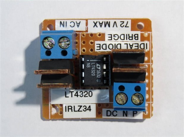

    This board is 3.7 cm  by 3.3 cm and here is the other side, all labeled up as is my nature:

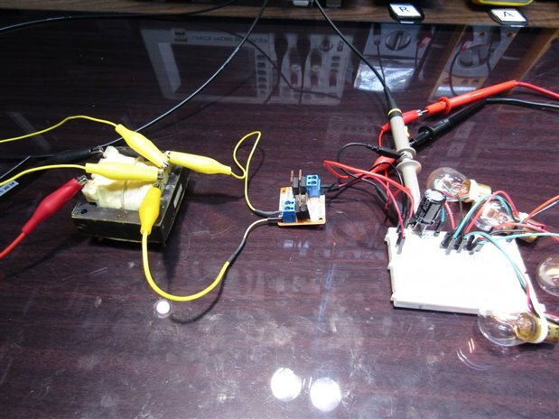

    I hooked up the new board and set up the same experiment as I performed in the original post and here are a picture of the set up and the results:
                                  Diode Bridge             LT4320 & MOSFETs              LT4320 & MOSFETs
                                                                                     (Original Bread Board)          (Prototype Board)
    Input Voltage          25.75 VAC  60 Hz           25.75 VAC 60 Hz                  25.75 VAC 60 Hz
    Output Voltage       27.95 V DC                     29.4 V DC                            30.76 V DC
    Ripple                    2.68 V PP                        2.68 V PP                             2.96 V PP
    Load Current          390 mA                               400 mA                                420 mA
    Here are the pictures of the Meters and Scope:
    The output of the traditional diode bridge was 27.95 Volts and the output of the LT4320 Ideal Diode bridge was 30.76 Volts. This represents a 10% improvement in voltage level for the same VAC input. This combined with the reduction of heat generation may make this choice a better one than I originally thought. After having to draw and wire this circuit several times it was not as confusing as it seemed at first either.
