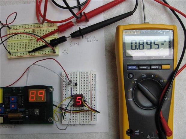

The electronic Frankenstein in me made me ask;  Can the third digit be added? A trip to the parts supply bins was successful. All that was needed was a common cathode seven segment display and a PNP control transistor. See pictures below. Wires were soldered to the circuit board. The pull down wires from the SN7446AN were needed as well as a +5 volt supply, the common ground, and an input wire to the AD converter. The data sheet for the SN7446AN was used to identify the segments associated with each wire. Here is the board after the extension wires were attached.
The third digit and the switching transistor were assembled on one small bread board and a 10:1 resistive voltage divider for the input to the AD converter was assembled on a second bread board. An old 9 volt battery was attached to the voltage divider and 1/10 of its voltage would be seen by the AD converter. The Fluke would give me an accurate reference. Here is the result:
There are 2 blue 5K trim pots between the CA3162 and the SN7446. The one on the bottom is used to set zero on the display. The upper trim pot is the gain and can be used to calibrate the ADC to the actual input voltage. Since the board did not have a Least Significant Digit until today it was necessary to tweak both trim pots slightly.
This board could now be used in an application where voltage needed to be measured to the millivolt level. The three decimal points are not used at this time but they are available so the board input could be switched using different voltage dividers to provide ranges of 0 to 0.999 volts, 0 to 9.99 volts, or 0 to 99.9 volts.
