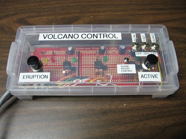

Throughout the summer I thought from time to time about the volcano project and how we could do something that would be safe and would give me a chance to get Ivan more involved in electronics. One of the times that he came over we salvaged out an old hair dryer. We removed the heater element and checked the motor blower. The blower was found to be quite powerful when run on 24 volts. Another time we built a small LED flasher using an astable 555 integrated circuit. Little by little we tried different ideas and experimented with them.
A week and a half ago the time finally came for the build to begin. Ivan and I decided that we would build the volcano with 4 channels of control.
Channel one would be a motor in the base of the volcano that would have a unbalanced pulley attached so we could make the volcano rumble. The motor would be driven by a 555 timer configured to produce a variable PWM drive to a FET.
Channel two would be a 555 astable timer configured to cycle slowly, about 1 HZ, and drive a FET that in turn would drive some LED strips on the volcano to simulate lava flows.
Channel three would be another 555 astable timer configured to a slightly higher frequency to flash another group of LEDs more rapidly.
Finally channel four would power the hair dryer blower which would blow a bunch of streamers from the mouth of the volcano to simulate an eruption.
Here are the schematics for the control circuitry, the battery supply, and the volcano. While Ivan let me do the designing I took him step by step through the logic and process of the the schematics so that the next time he sees a schematic he will recognize the simple components. We discussed the 555 timers and how they do not have enough power to drive the LEDs so they use the more powerful FETs to do this job for them.
The first schematic is for the battery box. I found a sale at the local Walmart and was able to get 4 sealed lead acid 6 volt batteries that are intended for use in Wild Animal Automated cameras. These batteries fit nicely into a small plastic box and would provide us with the 12 volt and 24 volt supplies needed for the project.
The schematic for the control box is pictured below. I will also include a picture of the finished control box. Except for a couple components all parts used in this project came from salvaged circuit boards. The case for the control is a Pencil Box that we got from an office supply company.
