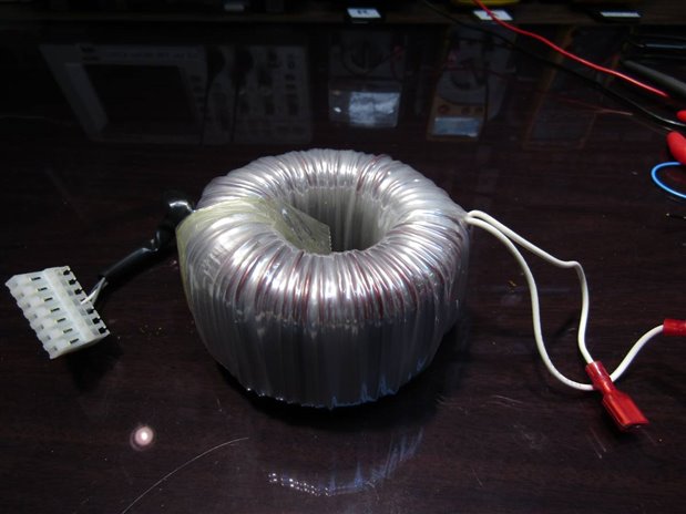

I have this beautiful Toroidal Transformer but it is 19 Volts and I need 24 Volts for my application.
It has a nice big donut hole and I have plenty of 16 GA solid enameled wire so I decided to add a few more windings. The first step was to figure how many windings I would need. I used some lighter gauge wire and wound 10 windings, hooked up the transformer and measured the voltage. I had 1.7 volts for the ten windings so 29 windings should give me the boost I need. This can't be too hard, I thought. I made a loose coil of wire and kept winding it around and around until I had the thirty that I needed. Next I secured one end of the wire to one of the existing wires and started to work backwards. I pulled the wire as tight as I could and went around and around until I had worked my way back to the last wind. Here is what it looked like.
Now that looks simple enough but I am writing this blog to let my hands stop aching. That was really hard work. I had to wonder how they wind these transformers when they have to put hundreds of winds on them. I can't imagine what kind of machine would be able to perform what I just did with my hands. If anyone knows how they do it I would really like to know.
I next used some cloth tape that I had and began to wrap strips around the transformer to hold the windings in place and to protect the wire. Here is the transformer after this procedure.
Finally I figured out the correct phase so that the voltage in my windings would add to the existing secondary and made a good solder connection. A few more winds of cloth tape to polish things up and I was done. A test of the transformer revealed 25 volts output with 118 Volts input.
Now that my hands are rested I am going to go back and make another one.

    Hi jw0752 , I thought it was a very good question when you wondered how commercial toroid winding machines work. Fortunately YouTube has the answer! https://www.youtube.com/watch?v=82PpCzM2CUg Nice work…

    If I had a slightly stiffer wire I would make a coil spring out of it on a cylindrical form and then screw the spring onto the transformer before tightening the winds one by one.

    They use special machines to wind toroid coils.
    As you found, doing it by hand is a real pain.  Pun intended.
    Now if you want to have some real fun, get some 30 gage wire and make a big step up transformer using the same core.
    You have a lot of magnetic field to play with.

    Lifehack (works only for trafo's where you can get at primary):
    If you don't have enameled wire and you need a not-drastic change, you can remove some of the primary windings. Warranty void.

    They apparently measure off the length of wire needed onto the hoop and then reverse the direction and wrap it onto the core. Very ingenious and a lot easier than the way I did it. My hands and arthritis are still killing me.
    Yes I thought it was ingenious too. I'd not really considered how this worked for volume production of transformers before until you raised the question, definitely interesting to see how it's done.
