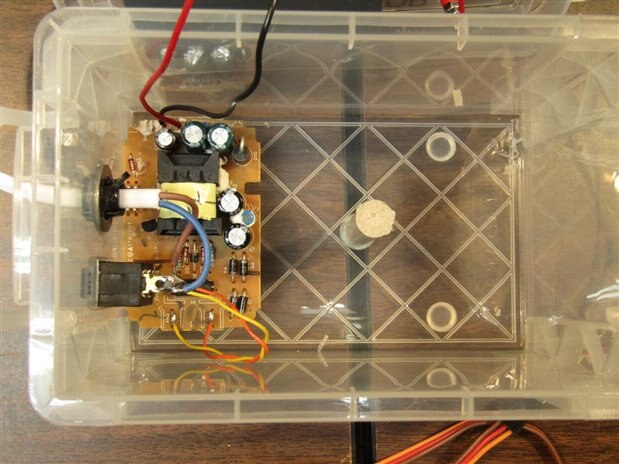

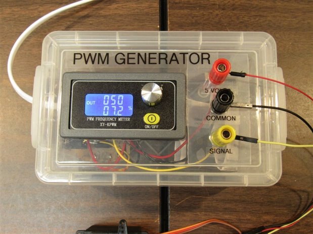

    Since I have been having quite a bit of fun with this PWM Generator I decided to make a simpler version with just a 5 volt power supply and the module as well as output binding posts. This will give me the ability to test small servos and to have a second more portable unit to test with.
    Here are some pictures of the build:
    The housing is a plastic box that I got at Walmart for a couple dollars.
    Here the unit is set to 50Hz and 7.2% Duty cycle which puts the servo at the 90 degree position.

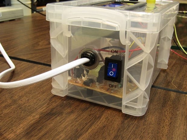

    Side View. I did as good a job as possible on the strain relief considering the thin plastic case. The metal washer inside is glued to the box and spreads out the strain. mcb1 always pointed it out when my strain reliefs were not good enough. Thanks to his prodding I am much more conscious of this safety concern now.

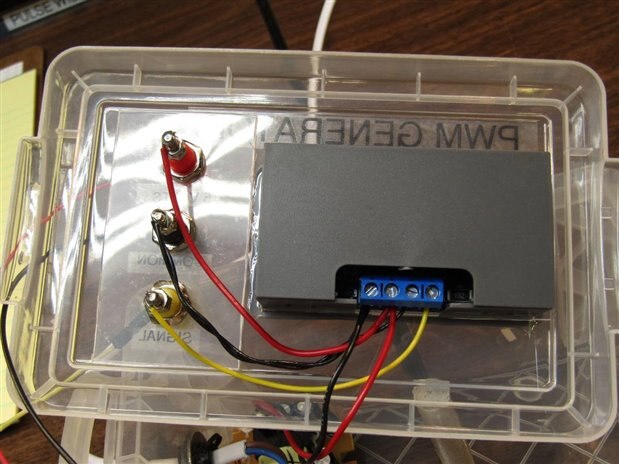

    The power supply for the unit is just a board from a 1 amp USB power supply. I have removed it from its wall wart case and mounted it to the bottom with a standoff.  The white post in the middle of the case is mounted to the bottom and provides extra support for the control module. It is necessary to push the control knob in order to cycle through the functions of the module and without the support pillar the top of the case would be flexed too much.
    Most of the modules that are available like this PWM module come with plastic fingers on either side that ramp into place and hold the modules into the front panel. These have never worked well for me as it is often difficult to get them to compress enough to fit through the panels. Recently I broke a front panel pushing one into place and subsequently I have begun to remove the fingers and to just glue the modules into the panels.
