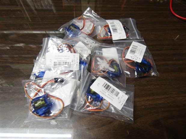

    Yes the 10 hobby servo motors have arrived and I have been able to use the new unit to test them for where their end lockup points are.

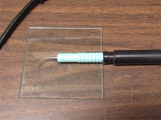

    Another application that I have for this device is to test the handpiece cords of Dental Cavitron Units. If you may recall from previous posts a Dental Cavitron is a device that has a point that vibrates at either 25kHz or 30kHz and is used by the dental hygienist to clean scale from ones teeth.
    When I have one of these devices on the repair bench it is useful to know if the cord and handpiece is working and at what frequency. The combination of wire coil and special insert have a resonant frequency that works best. Most of the modern cavitron units have the ability to auto tune to some extent. By using the new PWM Power Supply I can power up one of these handpiece cords with an insert and check the tuning to see where the resonant frequency is. Here is a short video of how this works.

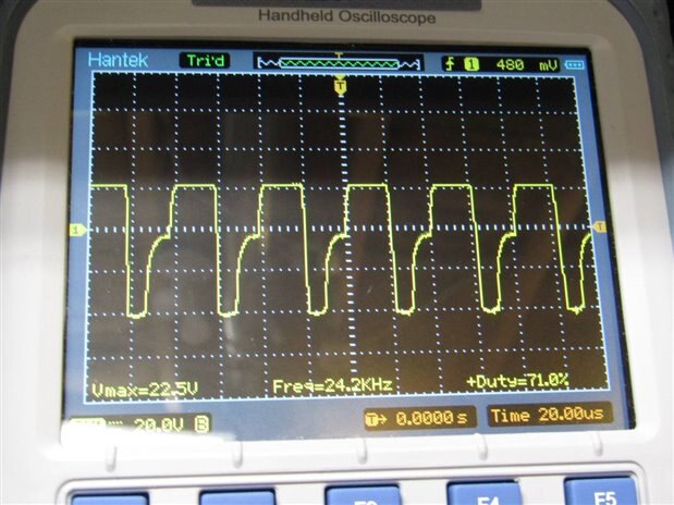

    Once I have the power to the tip high enough (about 7 Watts) and I am close to the resonant frequency I touch the tip to the glass and listen to the intensity of the sound. As I use the PWM Power Supply to move the frequency back and forth I can locate the point where the sound is loudest and this is the approximate resonant frequency. Here is a photo of the output of the PWM Power Supply as displayed on the oscilloscope.
