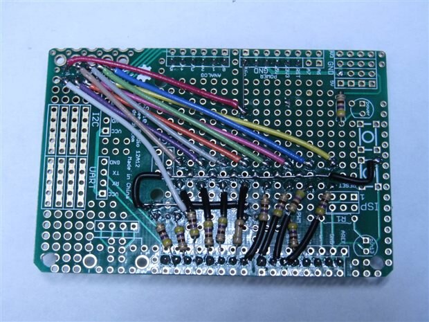

To power the LED Scanner I had decided to use the 2N7000 400mA  logic level MOSFETs. These, eleven in all,  had all been soldered into the board. and all the necessary connections had been made to the reverse side of the board. It was all neat and pretty except for one thing. It didn't work properly. It looked like most of the MOSFETs were showing a partial short from D to S.
A quick check with the meter showed that this was the case. 10 of the 11 MOSFET had from 10 to several K ohms of short between their drains and sources. My initial thought was that I had been careless with handling them and that static had gotten them. I hated what I had to do but I began to peal back the wiring from their contacts and with all the care and grounding straps I could find I replaced them one by one. At last reassembled I once again applied power and voila! Same problem, same appearance of partially shorted MOSFETS. So we dove back in for another go at it. This time I monitored the status of the MOSFETS as I went along. To my surprise they were being killed by me as they were being installed. At this point there was no way that static was to blame. Too many precautions and ground wires. It dawned on me at this point I was perhaps heat damaging them as I soldered them in. Because of space considerations the MOSFETs had been pulled down fairly tight to the board leaving about 3 mm of lead before entering the board. My solder iron does not have temperature control and runs at about 325 C. The data sheet for the 2N7000 says that it can tolerate 300 C on a 1/16 inch lead for 10 seconds. I think, from my experience, this is a bit optimistic. My usual technique is to minimize time on the contact but obviously something was damaging these parts. I got out the heat sink clips for leads and carefully began to replaced the remaining bad FETs. I continued to monitor them as I installed them. Since I was tacking wires and resistors to their solder pads It was necessary to make extra certain that time on the pad was minimized. I also sprayed coolant on the heat sink clips. Despite these precautions I still managed to kill a couple more. Finally after 6 hours and lots of frustration I had the machine up and running properly.
In all I killed 19 of the 2N7000 MOSFETS
Fortunately for the pocket book they are not expensive and while I did not have any left to spare after this debacle I did have exactly enough to complete the job.

    After having to spend so long reworking your board to replace all the broken FET's are you thinking it might be time to invest in a temperature controlled soldering iron? With the amount of stuff you build…

    Hi Rachael, Yes the thought crossed my mind. I am at this moment running some experiments to control the power to my present iron though this will only control the high temp and not really provide any…

    Very strange failures. I've used many of these particular FETs with no ESD precautions and no particular soldering care and I usually insert them all the way down on the board, and never seen one die. The only thing I do is form the leads prior to insertion so there is no stress on the leads. Very strange.
    Congratulations on your perseverance - nice job.

    I was surprised at how finicky they were. While I am not usually over cautious I am always mindful of potential problems. These caught me totally by surprise. It is possible that I got a bad batch or there may be another factor that I have yet to figure out.

    I'm not sure if they were new or recovered.
    I have 'broken' diodes by stressing the internal junction, so I'm with dougw on preforming leads now.

    I have made a note to preform in the future. Typically I have formed by force but I can see that this is just one more place to create a failure. I love this forum as I always learn new things and I am continually improving my techniques.
    Thanks for your and dougw insights on preforming the leads.
