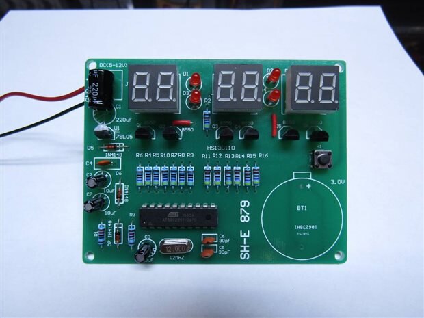

Here is my present best candidate for digital clock timer for the Process Duration Timer:
This is a $3.63 Chinese clock kit. The first thing that I liked about it was that it starts at 00:00:00 when power is first applied and then it begins to time immediately. As I built the kit I intentionally modified it with a mind to building it into the final enclosure. I left the LED display raised and made sure all the other components sat below the level of the faces of the digits. I left the memory battery off, as the fact that it will reset to 00:00:00 each time it is powered down if a asset for this application.
* First real problem is how to conserve the time on the clock when the transition of the monitored voltage from above to below the target voltage occurs. Keep in mind that the experiments that this unit will be timing may take many hours and I will not likely be there to look at the clock when the voltage transitions. It may be many more hours before I actually return and want to check the time. The clock system is built around an Atmel AT89C2051 Micro Processor and I have no access to its program nor do I have the skill to modify it if I did. My solution will have to be external and involve stopping the clock without loosing its current time register. I tried using the input switch on the unit to do this but all that it was programmed to do was reset the hours and minutes.

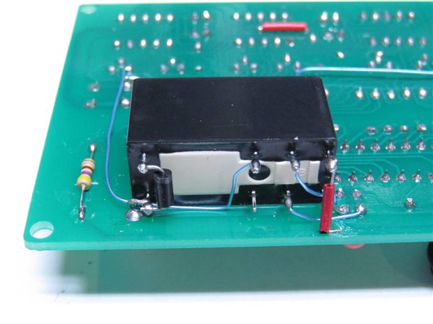

After some experimentation I discovered that if I disabled the oscillator clock to the AT89C2051 it stopped timing. I did this by pulling one side of the crystal to ground. (Question  - Is there any reason why this is not appropriate). When the microprocessor has its clock stopped a side effect of the stop is that I am also left with the current output to the LEDs which is usually a single bright digit on the display. I experimented with leaving the system in this state of suspended animation for 40 minutes and when I opened the grounded leg of the crystal the clock resumed at the exact time that it had when it was suspended.
The next step was to add a small 5 volt DPDT relay to the underside of the board. One of my concerns was that the additional capacitance of the relay structure that I was adding, to be able to pull the crystal lead to ground, might cause problems. I placed the relay close to the crystal and ground to minimize any capacitance. By now a good survey of the almost unreadable schematic supplied with the clock kit had given me a way to suppress the display of any digits while the clock is in suspended animation. There are six transistors on the unit that control whether a digit displays or not. These transistors all have a common emitter connect to the power supply. I used the second section of the DPDT relay to switch this power feed off to the transistors. In this way the energizing of the 5 volt relay puts the clock into suspended animation and blanks all the digits at the same time. I also used the other touch contact of this pole to light a red LED that I mounted in the place of the memory battery. After cutting some traces and adding a 470 ohm resistor for the LED the back of the circuit board looked like this.
You can see that I have also added a flyback diode to the relay to minimize a voltage spike when the relay is de-energized. The next step is to test the prototype of the timer to see if it does the things that I want it to do. First of all I want it to start off counting when power is applied at 00:00:00. Secondly I want to be able to put the timer into suspended animation for an indefinite period of time. The suspension will stop the clock pulse of the AT89C2051 and suppress the lighting of the digits in the display. To tell me that the clock is in suspended animation the red LED in the lower right corner should light. Here is a video of the proof of concept test.
I continue to be concerned about my use of the clock crystal for the AT89C2051 to produce the desired suspended animation. If anyone has any input or experience with this, your insights would be appreciated.

    Hi John, Clever idea, to freeze the clock as you have done : ) There are some other ways to do the freezing (e.g. use an external clock oscillator and gate it with (say) 'AND' logic, but that requires…
    jw0752 over 9 years ago in reply to jc2048 +4
    Hi Jon, Thank you for your insights. I will make certain the I am using XTAL1 for the grounding. I did look at using the Arduino and a Real Time chip briefly before turning to modifying the existing clock…

    I really don't know, it just seemed to me that shorting the input must be safe, but the output is a bit of an unknown and probably should be treated as any of the outputs would (ie you'd worry about the dissipation if you shorted it for more than a few seconds). Internally, the oscillator is usually represented schematically by an inverter with a resistor from output to input to bias it to the midway point so that it operates as an amplifier. The resistor has quite a high value (a couple of megs). You'd add an external resistor in series if you wanted to limit the drive to the crystal (crystals have a rating for the power they can deal with).
    Microcontrollers usually have different settings for high and low frequency crystals. I think that will relate to drive strength. I doubt that they switch a resistor in series with the output, it's more likely that there are a couple of pairs of output MOSFETs in parallel and one pair can be disabled for the lower drive strength. (That's the way that would occur to me to do it.)
    It is interesting that it works so well for John. As you say, the problem area is short cycles (or even short half cycles, because they may use both edges at the hardware level) which would mess up the internal timing.
    Perhaps it's because holding the input at the rail and then releasing it gives the thing a huge kick that guarantees to get it off to a good start. It would be interesting to see what the input and output looked like at that moment.
    I suppose, in a way, it's more remarkable that it survives the relay contact bouncing when it first shorts the input. When the processor is brought to a halt it's done in fits and starts, stopping and starting several times. Perhaps all the clock code is in an interrupt running off a timer and it will pick up and get going again regardless of what you do to it.
