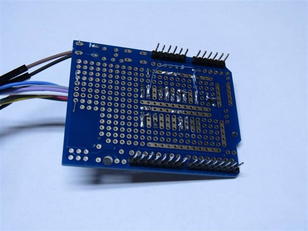

If you have followed the previous 3 posts about this project you know that we are at the point where the rubber meets the road. I have now put the interface circuits, that were previously on bread boards, on to an Arduino shield board. The shield will make all of the necessary connections to the Arduino. The connections from the interface board to the rest of the circuit are being assembled so that I will be able to easily disconnect and remove the interface board for modification or service if necessary. Here is a picture of the completed interface board:
I have also improved the schematics for the interfaces and included the hookup wire color that is being used to assist me if I have to troubleshoot the unit in the future.
As mentioned before both of these circuits have been installed on the Arduino Shield board.
For the power hookup which brings 9 volts to the Arduino I have made up a polarized connector using board headers. The rest of the connections to the peripheral circuit are going to be made with Male-Female bread board wires which I have cut in half to produce a color coded connection (see schematics for colors used). While these wires are really quite small gauge they are more than adequate for this low current application. Half of the cut bread board wire is attached to the interface board and the other half is attached to the appropriate point on the peripheral circuits. I always put the female ends on the wires that may be powered when disconnected so that they can not short to other wires or components. Here are a couple pictures of the unit with and without the interface board installed.
