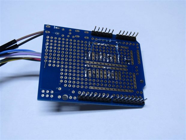

If you have followed the previous 3 posts about this project you know that we are at the point where the rubber meets the road. I have now put the interface circuits, that were previously on bread boards, on to an Arduino shield board. The shield will make all of the necessary connections to the Arduino. The connections from the interface board to the rest of the circuit are being assembled so that I will be able to easily disconnect and remove the interface board for modification or service if necessary. Here is a picture of the completed interface board:
I have also improved the schematics for the interfaces and included the hookup wire color that is being used to assist me if I have to troubleshoot the unit in the future.
As mentioned before both of these circuits have been installed on the Arduino Shield board.

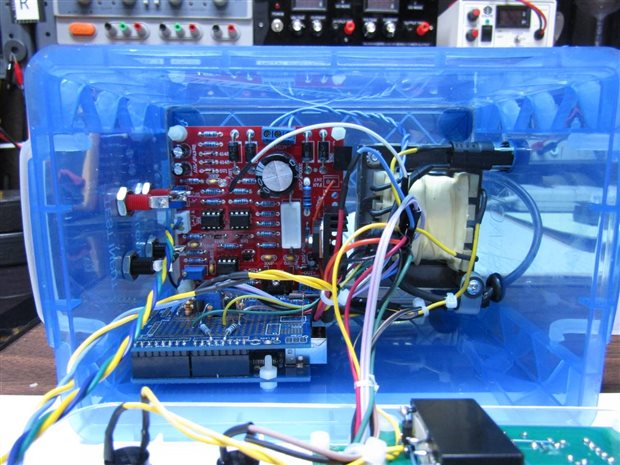

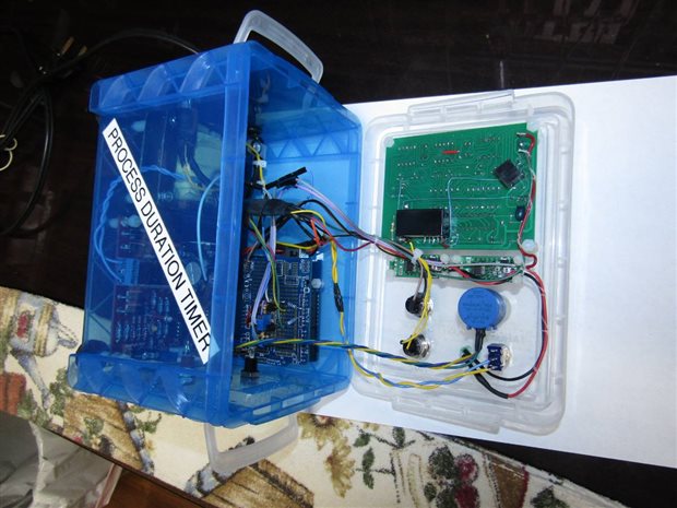

For the power hookup which brings 9 volts to the Arduino I have made up a polarized connector using board headers. The rest of the connections to the peripheral circuit are going to be made with Male-Female bread board wires which I have cut in half to produce a color coded connection (see schematics for colors used). While these wires are really quite small gauge they are more than adequate for this low current application. Half of the cut bread board wire is attached to the interface board and the other half is attached to the appropriate point on the peripheral circuits. I always put the female ends on the wires that may be powered when disconnected so that they can not short to other wires or components. Here are a couple pictures of the unit with and without the interface board installed.
With projects like this I like to layout the wiring harness so that I can open the unit and have access to the circuits without having to stress the wires or their connections. To do this I make sure that the wires all pass over the same edge so that the cover can be laid back as in this photo:
This point in building a project is always the most nerve wracking for me as I am about to turn the unit on for the first time. Though I have checked every connection there is always a chance that it may not work or worse yet there may be smoke and fire. If that happens it would force me into skipping sleeping tonight so that I can get to the bottom of the problem. Fortunately I have been lucky this time and everything comes on and works as planned. I have made a short video of the first tests that I performed on the unit using my power supply to provide the test voltage which I could decrease until it fell below the target voltage.
