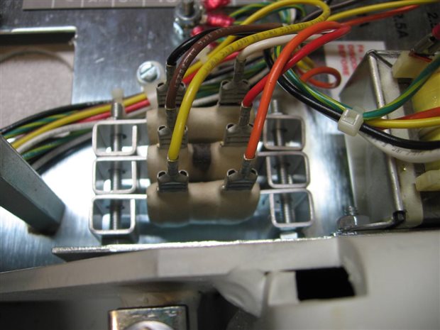

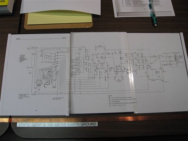

This unit failed when a wall actuation button became shorted out. This caused the unit to experience a long duration voltage to a couple of key resistors. These resistors are sized to handle the voltage that was applied but only within a duty cycle of seconds. The shorted switch caused the seconds to turn into minutes and the resistors continued heating until one of them fused and the other one carbonized. I have seen this same problem several times in the past and there is never any collateral damage except the resistors themselves. Here is a picture of the block schematic for the unit and a couple pictures of the damaged parts.
This is a poor picture, the bad resistor is along side the small black relay. A better picture of the replacement resistor is further down in the blog.
The middle 30 Watt resistor in the stack has a black band of thermal damage.
I have always been impressed with the simplicity of the design of the Gendex 770. The Head ( the part that actually produces the x-rays) contains the x-ray tube, and a transformer that produces the high voltage 70,000 volts and the voltage to heat the filament of the tube. The transformer, the tube and its support structure are immersed in special oil that serves as an insulator and a coolant for the components. Here is a picture of a dental x-ray tube.

The middle resistor in this stack, a 30 W 15 Ohm, is the new replacement. This is the resistance that is put in series with the power to the x-ray head while it is in the warm up, 22 pulses, period. While the voltage applied produces more current than the resistor can handle continuous duty the 1/3 second of the warm up is too short to damage it.

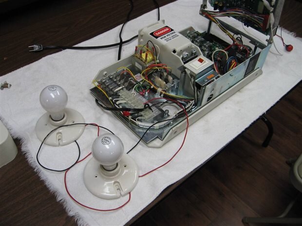

Now having replaced the bad parts it is time to test the control to see if it is working properly. For my purposes I will not be testing it with an x-ray head. I will be testing it using a couple of 100 Watt light bulbs. I have connected the 100 Watt bulbs in parallel with the output that usually goes to the x-ray head. I have also jury-rigged a momentary push button to the trigger circuit of the control so I can trigger an exposure. This works well as I do not have to be concerned with ionizing radiation and I have only been asked to repair the control. Son Matt will hook up the head and test and perform calibration of the x-ray before he sells the machine. Here is what my test setup looks like:
