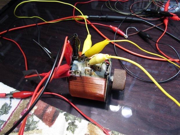

The heart of this project is a small variac, about the size of a soft ball, that I salvaged from an old Ritter Dental X-ray.
Besides the full 0 to 110 volt sweep contact this unit also had hard taps at 8, 17, and 55 volts. My plan is to rectify the 17 volt tap and use it to drive a 7812 regulator which in turn will provide the power for the fan in the gun. My test of the fan motor showed that it drew 0.25 Amps at 12 Volts and ran with enough RPM to serve my purpose. The 7812 can handle 1 amp when heat sunk so with a small radiator it should be able to dissipate the watt or so it will be required to shed.
