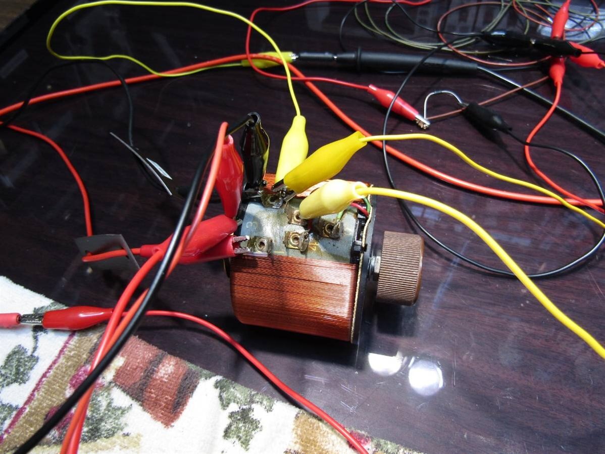

The heart of this project is a small variac, about the size of a soft ball, that I salvaged from an old Ritter Dental X-ray.
Besides the full 0 to 110 volt sweep contact this unit also had hard taps at 8, 17, and 55 volts. My plan is to rectify the 17 volt tap and use it to drive a 7812 regulator which in turn will provide the power for the fan in the gun. My test of the fan motor showed that it drew 0.25 Amps at 12 Volts and ran with enough RPM to serve my purpose. The 7812 can handle 1 amp when heat sunk so with a small radiator it should be able to dissipate the watt or so it will be required to shed.

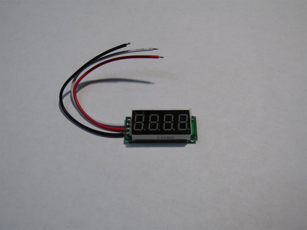

The challenges in using this module are that it is DC, doesn't read directly as high as I want to go, and requires an isolated power supply from the variac to do what I want it to do. I experimented with using the 8 volt and 17 volt taps on the variac to power it but I was not able to get it to zero. Finally I took an old linear 7 volt wall wart, broke it apart and used it to supply the power for the LEDs and logic. This allowed me to get accurate readings on the sense line. In the final design I used a 100K potentiometer as a voltage divider to to bring the voltage to the meter down one magnitude and then manually moved the decimal to properly reflect the real voltage. With a 4 digit display and no need for that much accuracy it left me with a good solution and the meter now displays 0 to 110 volts while actually sensing 0 to 11 volts.

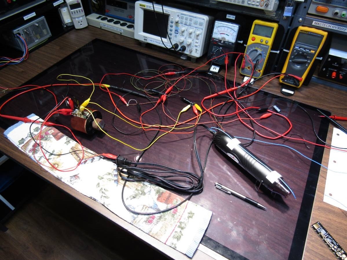

Before I began the actual build I wanted to do some bench testing and to run some empirical measurements of current versus output temperature. For those who feel my bench is always too organized here is proof to the contrary.
While I am working with some mains voltages in these tests I have taken special precautions to use isolated sources and good test procedures. Unfortunately sometimes there is just no way to make it look nice and get results in a reasonable time frame. Here is a graph of the Temperature versus Current characteristics of the heat gun. I have a very inexpensive two channel thermocouple based thermometer. I tested the thermocouple for accuracy using boiling water and ice in water. It actually tested extremely accurate considering it only cost $13.00. I placed one of the thermocouples 2 cm in front of the outlet of the heat gun and taped it in place. I wanted my readings to be consistent. Finally I fired the test up and took readings at 10 volt increments from 10 to 100 volts. I also used a second also inexpensive thermometer and you can see the difference between the black and red graph lines.

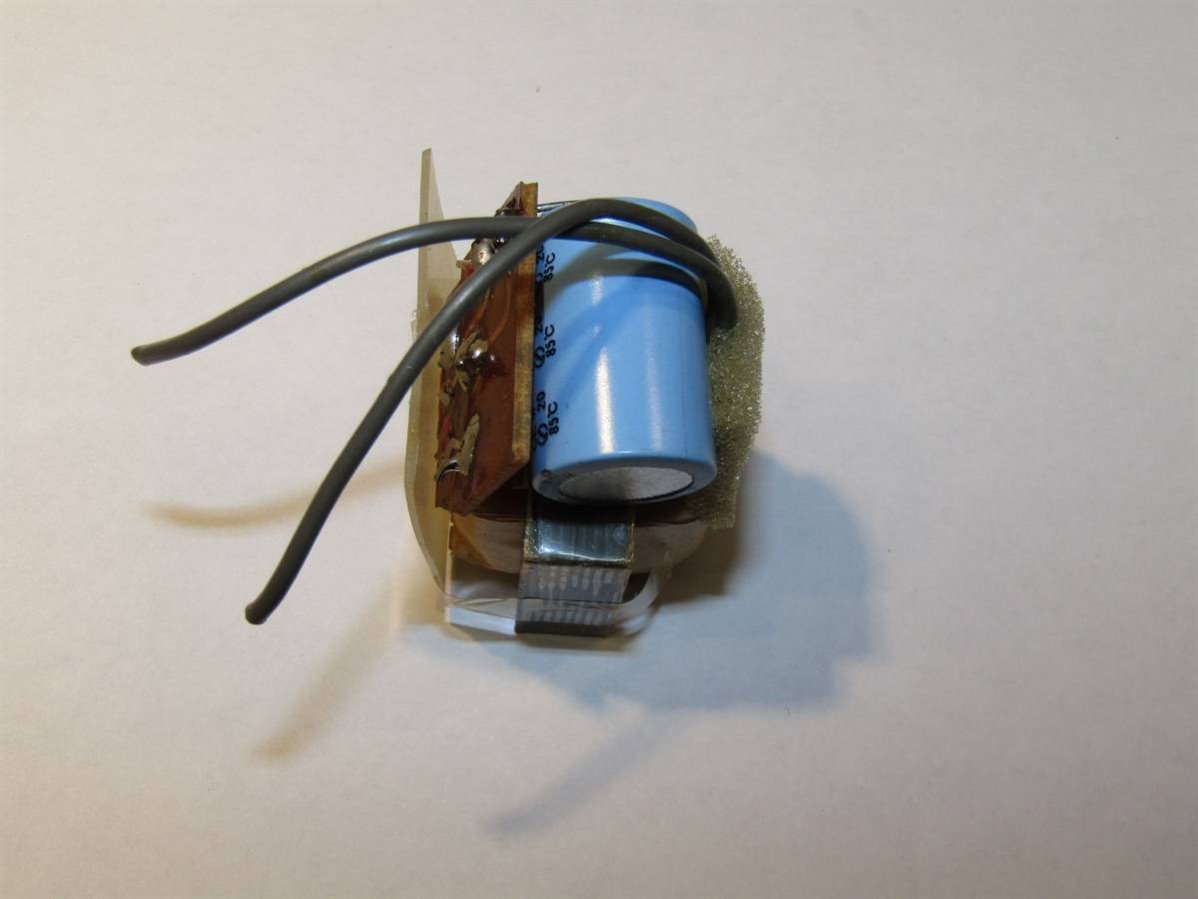

This will give me a rough estimate of my temperature output based on the voltage shown on the meter. Once I was convinced that things would work as envisioned I began the build. I had to make the small circuit for powering the fan motor and also one to adapt the AC voltage from the variac sweeper to what would be acceptable for the meter. The small isolated power supply for the meter's electronic was already built. Here is the motor board in progress.
and the salvaged wall wart:

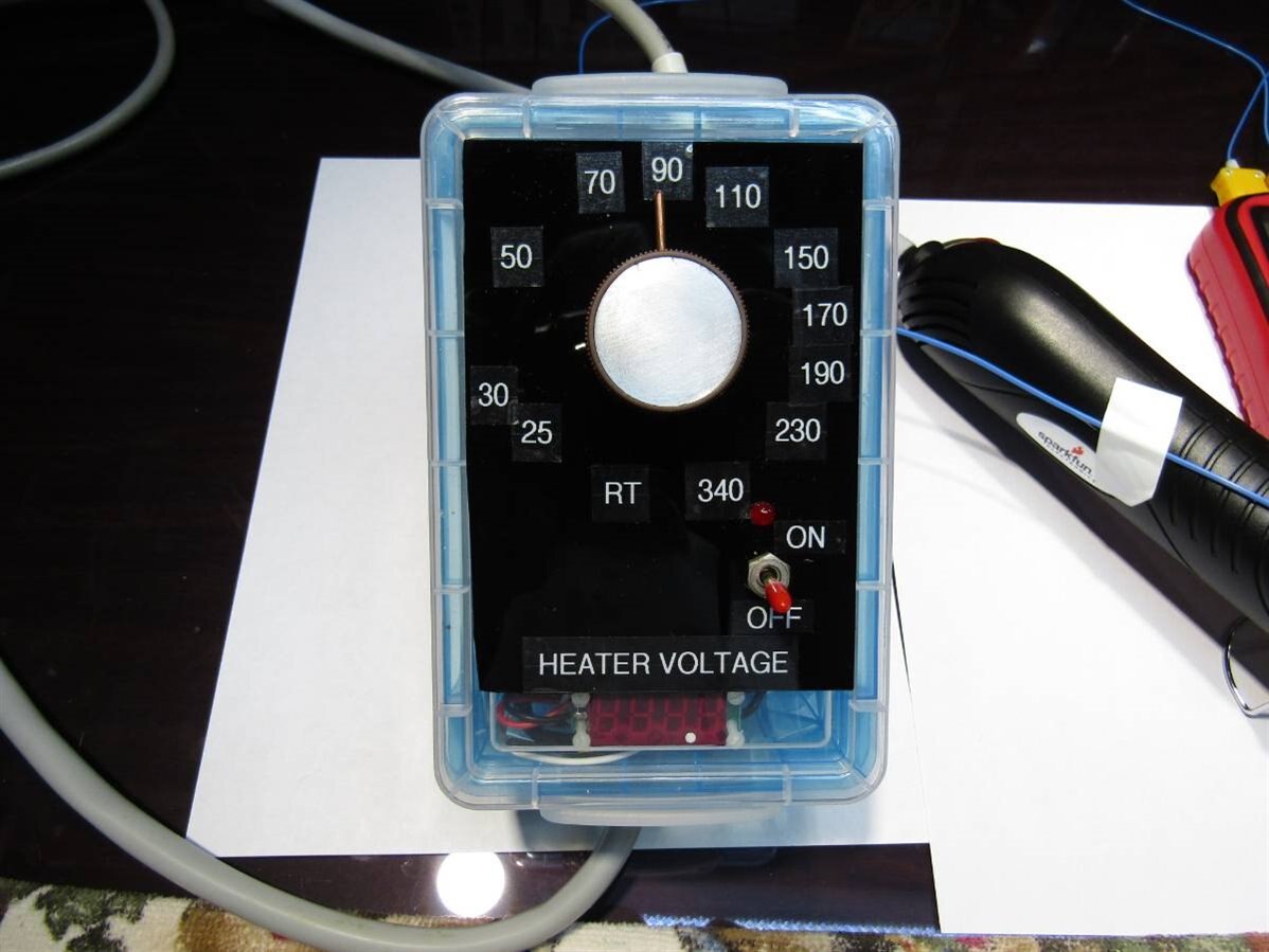

The construction preceded with the customary glitches. I had a bout of dyslexia and hooked the variac up backwards on the first test. I put way too much voltage on the fan motor for a split second and had to make a repair to the motor board. By the time I got things straightened out it was 3:30 AM. Once I knew it was working I went to bed and planned to put the finishing touches on it in the morning which begins about 10:00 AM for me. Here is the finished unit. The little thermocouple thermometer is still attached in the picture as I was running final tests and I wanted to place temperature labels on the face of the unit so I wouldn't have to use the graph to convert voltage to temperature. Here is the finished unit.
