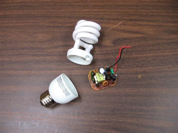

Everyone is familiar with the Compact Fluorescent Light or CFL. Since they appeared on the scene they have invaded our homes and pushed the poor old incandescent bulb nearly to extinction. Most of the CFLs that I have purchased had 5 year guarantees and bragged about 5000 hours of service. Unfortunately based on the number that have failed I believe that this is a bit of an exaggeration. A while back I stopped throwing them away outright and started salvaging them for electronic parts. Here is a failed bulb that I am about to crack open.
I open the base of the bulb by putting a flat screwdriver in the crack and twisting. Sometimes it is necessary to tap the screwdriver into the plastic before I twist. While the glass tube is attached it is a good idea to handle the bulb with a pair of work gloves. If the glass breaks it would be dangerous and if you slip with the screwdriver the gloves will protect you. Once the base is open you will find a small circuit board attached to the base with two wires and also to each of the tube ends with two wires.
Cut the wires to the base and the tube and dispose of the base and tube. Be sure to save the high temperature pieces of spaghetti that cover the wires as they can be very useful for future builds. Sometimes there will be a small inline 2A fuse also. The next step is to clamp the circuit board and begin to remove the parts with your solder iron. Nearly all the boards I have encountered have the same basic parts on the board. They vary slightly from manufacturer to manufacturer but almost always there is a similar bill of materials.

    Glad to help & share the information around Good luck with those repairs - watch out for the charge held in the large electrolytic during the repair! Chris

    Hi John, Great post. I had not thought to look inside the CFL's, but you have opened new toys for me to explore. One note of safety though, sometimes they use some bad metals to coat the glass with. So…
    DAB over 10 years ago
    Hi John,
    Great post.
    One note of safety though, sometimes they use some bad metals to coat the glass with.  So make sure you where a face mask so as not to inhale any of the dust.
    The rubber gloves ae also useful as some of the metals can be absorbed by the skin.

    Thanks DAB. So far I haven't broken any tubes but there is always that possibility.
