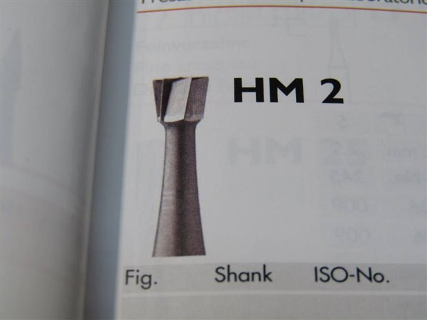

Tonight I assembled some parts and made some tips that solve the problem of penetrating the epoxy, are not dangerously sharp, are very durable, and are easily replaceable. To do this I am going to adapt another piece of Dental technology, the drill or bur that is used to cut tooth material. One particular bur numbered 557 is a good fit for my needs:
The 557 bur is about 1.5 mm in diameter and a little less than 2 cm long. The tip of the bur that usually cuts the tooth material is made of tungsten carbide and has flutes along its sides and has a sharp star pattern on the tip itself. My plan is to make a chuck for the dental burs and mount the chuck on a meter probe handle. I will have wires coming from the chucks back to pin jacks which will accept the tips of my normal meter probes. Now when I need to probe a board covered in epoxy I will attach the new probes to the meter probes and use the dental burs as the tips. Here is how the fabrication came together. Please excuse my poor machining which is 50% having very cheap tools and 50% having a poor machinist. Here is a picture of the assembled probe tip:

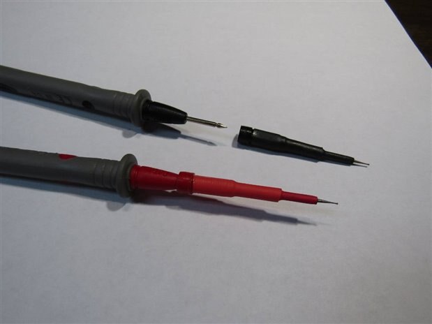

    Here is one more iteration of the idea. I have made adapters to go one the tips of my meter probes and eliminated the extra wire. John

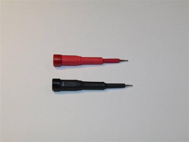

    It has been almost a year since I first blogged about what I was then calling the "Intrusive Meter Probe". As is the case with most ideas it has continued to evolve since I first started working on it. While my first search was for a tip that could easily penetrate the coating on circuit boards the secondary property of not slipping from where it is probed has turned out to be a much more important feature. Over the last year I have made a few successful prototypes and many unsuccessful ones. The latest prototype which is billed as a "Non Slip Meter Probe Adapter" is a 5 cm adapter with a 2 mm pin jack on one end and a friction grip chuck for the actual tungsten carbide tip at the other end. Here is a picture of the Adapters:
    I envisioned that they would be placed on the ends of existing standard meter probes like this:

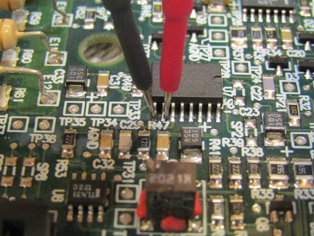

    We have also been experimenting with a variety of sizes for the actual point of the tip. The tip itself is an array of 6 carbide blades at the top a of an inverted come. The cone shape gives the six blades a slightly outward orientation. This allows them to grapple into vertical and slanted surfaces that a standard tip would slip off of. The points are available in 4 diameters that range from 0.6 mm to 1.2 mm. The 1.2 mm size is the best at holding position but I found that its size was a problem in tight circumstances. The 0.6 mm is the easiest to get into small places but its size is approaching the size of a single sharp point and it displays many of the drawbacks of a single sharp point. The 0.8 mm tips have turned out to be the best compromise and it is the size that all of my current prototypes are being sent with. One objection that was put forth was that the tips would damage the traces or solder pads that they probe. I have not found this to be the case. In fact the ease of making and keeping initial contact does less damage than a regular probe tip. This is because the Non-Slip tips require very little pressure to keep them in place and a single touch with one or two of the six points is all that touches the lead or pad of the component that is being probed. Standard tips on the other hand slip and have to be place with pressure several times before a good seating position is obtained. Here is an enlargement of the point on the probe tip:
    I find these tips relaxing to use as I no longer struggle to find a position and pressure that keeps the probe from slipping. Aside from the fact that they do not slip the other surprise is that they do not need the pressure that is usually required to make a good connection. The non-slip ability makes it possible to transfer the two probes to one hand leaving the other hand free to turn adjustments or take notes. The non slip quality also lets me probe live circuits with more confidence. Have you ever had a probe tip slide off the intended IC lead and short out to a lead you did not intend to touch? Though I am sure that they will not cover all the possible needs when probing circuits, I have been able to probe adjacent leads on a 48 lead uP IC. However if you have lead spacing of less than 0.8 mm it might be necessary to go back to a needle probe.
