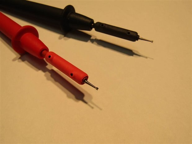

I frequently work on circuit boards from Dental Equipment. Since these circuit boards are often used in wet or humid environments the manufacturers like to coat the boards in a thick layer of epoxy or other hard sealant. Probing these boards has always been a challenge as my meter probes would not penetrate the epoxy and I would get false readings on the components under test. The usual method for working with boards like this is to use probe tips that are very sharp and to push hard until a reading is registering on the meter. The sharper the tip the faster they dull and break and it is a nuisance to have to be constantly sharpening. In addition once you have sharpened and the nice nickel coating is gone the underlying brass is way to soft to hold a point. The final frustration with these very sharp tips is that it is easy to get stuck by them.
Tonight I assembled some parts and made some tips that solve the problem of penetrating the epoxy, are not dangerously sharp, are very durable, and are easily replaceable. To do this I am going to adapt another piece of Dental technology, the drill or bur that is used to cut tooth material. One particular bur numbered 557 is a good fit for my needs:
The 557 bur is about 1.5 mm in diameter and a little less than 2 cm long. The tip of the bur that usually cuts the tooth material is made of tungsten carbide and has flutes along its sides and has a sharp star pattern on the tip itself. My plan is to make a chuck for the dental burs and mount the chuck on a meter probe handle. I will have wires coming from the chucks back to pin jacks which will accept the tips of my normal meter probes. Now when I need to probe a board covered in epoxy I will attach the new probes to the meter probes and use the dental burs as the tips. Here is how the fabrication came together. Please excuse my poor machining which is 50% having very cheap tools and 50% having a poor machinist. Here is a picture of the assembled probe tip:
I have taken a piece of solid brass rod and threaded it so that it will screw into my probe handle. I next drilled a 1.5 mm hole down the center to accommodate the bur. Finally I cross drilled and tapped a hole for a set screw to retain the bur. Here are all the parts for the probe extensions before and after assembly;
Placing the bur on the epoxy above the pad or component that I want to probe and with light pressure and a slight twist the sharp points of the bur cut down to the metal and a dependable reading is obtained on the meter. These burs are very common and probably can be purchased from any dentist. You will find that even used burs will work well as the dentist uses the flutes on the sides to cut and we are mainly interested in the star flutes on the tip. The bur shaft is made of steel and the tips are tungsten carbide. This material has a higher resistance than the usual metal used for probe tips. My probe extensions and tips added about 0.1 ohm of series resistance which I can mentally add into my readings. It of course doesn't impact the voltage readings.

    I have continued to work on this idea and to refine it. The goals that I had for this iteration of the idea are to modify a set of meter test probes so that the probe itself has a friction chuck whereby I can insert and remove the dental bur tips without having to have the bulky adapter or for the need of an Allen wrench to change the bur. Here is a picture of the black probe that I am going to modify. Notice that the tip is removed by unscrewing it from the sheath. The screw thread is a standard 10-32 USA thread.
    I began by looking for a suitable friction grip chuck and mounting to replace the original point on the probe. The tips are dental burs and they are generally used to cut teeth in a dental drill so I went to my sons dental equipment repair shop and got some old parts from the mini turbines that are used in dental drills. Below I took a picture of a sequence of changes that I made to the parts called spindles and to the chuck which is inside the spindle. The picture on the left shows the spindle as it comes from the dental drill after the bearings and the turbine blades have been removed. In the second picture I have started to back the chuck out of the spindle with the chuck completely removed in the third step.  The fourth step shows the chuck flipped 180 degrees and screwed back into the spindle in number five. Since the threads do not continue very deep we hit a stop position. The final two pictures show the bur about to be inserted and then seated into the chuck.
    The spindles come with a shoulder that will not be needed in the final construction so I will grind it off. Next I took a 10-32 screw and drilled a hole down the center of the screw and cut a section to slip over the chuck. Here is a picture of the spindle and chuck assembled with the screw threads compared to the original probe end.
    In the final assembly the probe wire is soldered into the spindle and the unit is screwed back into the probe handle. The finishing touch is accomplished by adding some colored heat shrink. Here are what the finished probes with friction grip chucks for the probe tips looks like.

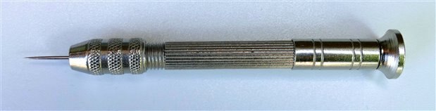

    For penetrating probes I use sewing needles with an alligator clip lead - they work well and the price is right. Some alligator clips are totally covered with an insulating boot that allows you to pinch the jaws for extra force.
    I just purchased a jeweler's screwdriver chuck to be used as a tap, but the chuck is too small for the taps I use, so I stuck a needle in it and put some heat shrink on the handle.....shown before the heat shrink because it is more photogenic this way...
