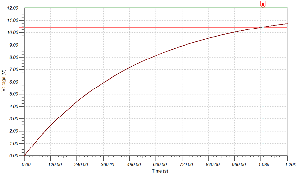

    I was curious about the 35 minutes for the timer. Too lazy to do the calculations, I gave it to SPICE  (Tina-TI) to do. Here's the graph for a 220u charging from a 12V supply through a 2.4M resistor. The time to the switching point defined by  R2 and R3 (10.46V) looks to be just over 18 minutes (1080 seconds). That's with a perfect resistor and a perfect capacitor.

    So why the difference between the calculated value and what you're seeing in practice? The first possibility is obviously the tolerance on the capacitor value. Electrolytics aren't very good in this respect: I've just looked up a few on the Farnell site and +- 20% seems to be common now, though that's much better than was once the case.
    But even if you were at the extreme of the tolerance range (very, very unlikely), that only gets us to 22 minutes. The resistor also has a tolerance on its value but that will be much better than the capacitor and I'm going to ignore that for the purposes of this comment. The rest will be other currents stealing from the charge current.
    The first to consider is the leakage of the capacitor. Once we get to 10.46V the resistor current has reduced to 0.64uA. [I calculated that using Ohms's law (12V - 10.46V) / 2400000 ohms = 0.64uA] A Panasonic electrolytic datasheet I looked at gave a leakage current of less than 3uA over the temperature range. In your case, for your particular capacitor and at room temperature, it must be much better than that or you would never have even reached the switching point.
    The other, perhaps less obvious, current [not really "leakage"] is the input bias current of the comparator. The (TI) datasheet gives a typical figure of 0.1uA without properly stating the conditions, but the datasheet is a bit of a mess and another of the graphs shows it varying depending on the differential input voltage [which is what you would expect] - so something in the area of 0-150nA. From the circuit given in the datasheet it looks like it flows out of the chip [base current of PNP transistor], so, curiously, it will be countering the capacitor leakage to an extent.
    Well, that's about as far as I can go with my musings. The point I've come to is that, whilst your circuit is absolutely fine as a one-off personal project (which is all you intended, so no criticism meant) if someone were to come to you and ask you to produce 10,000 to sell you might want to be a bit cautious. The circuit is operating in a marginal area where you would either need to do work characterising the parts yourself or take a chance (ie gamble, since money would be involved) that they were always as good as in the prototypes you had built. In practice you would probably decide to take a look at the CD4060 that D_Hersey suggests, which is a much more controlled way of timing over a period of more than a few minutes, or use the kind of small and very simple microcontroller that sells for a few 10s of cents.

    Just as I have come to expect from you, excellent analysis of the situation. I set up the prototype circuit and used empirical analysis to determine that the time in seconds for my circuit was C times R times 3 = T in seconds. The "3" being my reality constant. This is of course 3 time contants which would in theory put us closer to 11.4 volts if there were no reality to deal with. I also tried a number of values for C and R and found that the formula was fairly accurate. I picked out a good quality capacitor from my bin as I wanted to minimize leakage since I knew that this could be a factor in this marginal area of operation. This formula worked equally well with an LM 339 and a LM 311 comparator using the same resistors and capacitor. I am aware of the 4060 and even have worked with one a while back. It would have been a better choice for the project as you and D_Hersey have pointed out. For a more commercial application of the idea the power supply and timer could be put on the same board. I also could have designed the circuit to turn off the power supply completely when not in use with 3PDT relay and a DPST momentary pushbutton. It is enjoyable to make these "one-off personal" projects as they do not carry the stress and responsibility of doing something commercially. I have done the commercial things and they always give me high stress levels with all the side effects that come along with a large pool of users. Thanks again for taking the time to troubleshoot my design. Your input is always respected.
