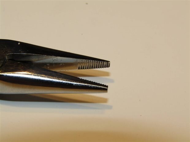

Since one of my incentives for going quality was to see if I could show up dougw by picking up a smaller than 40 Ga wire I started my experiment with the Aven 10305 with the round nose and the serrated jaw.
A search of the wire room turned up some very high strand wire with individual wires of .002 inch (.05mm) diameter. This should be 47 AWG. The wire was fine enough that I had to use a permanent black marker to paint it and make it visible to my video recorder. I made the wire as straight as I could and I laid it out on a white sheet of paper so it would be visible. I took the 10305 pliers and tried to pick it up. The pliers had no trouble picking up the wire. Here is a video of the experiment. My apology as videoing this experiment is at the extreme end of my camera's capability and slightly beyond the videographer's skill level.

The next pliers that I wanted to check out was the extra long nose 5 inch needle nose Aven Technik 10311.
As you can see from the pictures it has a smooth jaw. This style of pliers is used by me to make tight bends in wire and also for pressing out bends and kinks in component leads. The longer nose can be used to place and retrieve small components deep in tight places. I also tried and performed the 47 AWG pickup with the tip of this pliers. Having worked so long with inexpensive tools I had to perform the pickup 4 times, each with more glee and delight. I did not video this but I am ready to defend my claim at next years element 14 World Convention in Toronto.

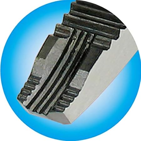

    shabaz over 7 years ago in reply to Fred27
    They look really useful!! Nice to see the designers got creative with the handles too : )
    jw0752 over 7 years ago in reply to Fred27
    They remind me of snow tires for the car, nice set of jaw treads.
  • luislabmo
    luislabmo over 7 years ago in reply to Fred27
    Hi David,
    Those are called screw pliers or screw removal pliers. I learned they existed when I was researching some Engineer (brand) tools. They are very handy to remove rusted/stripped head screws. I just learned one of their models are called "Neji-saurus" kind of similar to what you googled to find them.
    Luis
