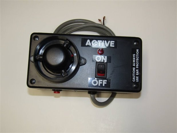

My solution to this problem was a device that was called "The Squealer"  Here is a picture of one of the first marketable prototype.
The Squealer was a duty cycle monitor that would measure the amount of time the dental compressor was actively running and compressing air. The time could be set at installation from 1 second to 512 seconds. The controlling device was a "delay on make" timer that would start timing when power was applied and then close the contacts after the prescribed time. If the time limit was not exceeded the unit would reset and wait for the next compressor cycle where it would again time the cycle. If the compressor cycle ran longer than the preset limit the Squealer would emit a very loud 110 db siren. It was necessary for the siren to be very loud as many of these dental compressors were in utility rooms that are isolated from the clinic's staffed areas. You can see that the Squealer would catch a leak problem in the early stage of the failure well before and serious damage would be done. Roughly 50 of these devices were made in my shop and test marketed to the dentists in my service area. They worked well, at least at first, but there were problems as well.
The first problem that I had trying to market these beyond my own area was that they had to be tied into two 220 volt sources on the compressor that was being monitored. I needed a 220 volt source for the siren electronics and I needed to monitor the 220 volts that went to power the compressor head. Dental compressors from different manufacturers wire their machines differently and as such the Squealer would always require a technician capable of working with 220 volts to install them. The Squealer was not a turn key device that could be marketed to the dentist. Still every one of my dentists who had a Squealer were no longer in danger of loosing their compressor to a simple long term air leak and there were several over time who benefited from this protection. After a year of so in the field it was noticed that there was a second problem with the Squealer. I had mounted most of the units directly on the compressor. Over a years time the vibrations of the compressor had broken wires and caused components to break loose. This became enough of a problem that I went back to the drawing board and redesigned the Squealer.
Enter "The Squealer II".
The Squealer II was smaller and simpler. It only required a hookup to the 220 volts power that was supplied to the compressor head. The internal electronics were on a circuit board and there was a simple timing circuit that was adjustable to set the time duration before the alarm would sound. This unit was a definite improvement over the first model and a large portion of the originals were replaced with the Squealer II model. The problem however remained that it was still not a turn key unit as it still required a technician to tap into the 220 volt feed to the compressor head.

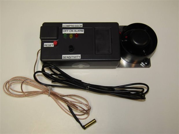

In the mean time I had been busy contacting potential marketers for the product. The dental industry is very controlled and it is difficult to get anything to market without the interest of one of the major players. I had gotten one of these players interested but I could not get them to move on the project. I knew that long term the unit needed to be redesigned to a turn key configuration but at the time I did not have the electronics skill to do this. I hoped the marketing partner would find someone to take the idea and help me redesign it but this never happened. The project never got off the ground with this vendor and after wasting more than a year I pulled the commitment back and went back to searching for a marketing partner.
I was determined that I would improve my electronics enough to make the unit a turn key device that could be purchased by the dentist and installed without the need of a technician or the need to make a hard wire attachment to the compressor. I began this process in 2013 and by September I made contact with a new web site (element 14) as I searched for answers to some of my electronics questions. At the time I addressed my first question, related to an Arduino I was attempting to use, to Jeremy Blum. Jeremy never answered me but mcb1 did. My continued education and experimenting with the help of Mark and others at element 14 eventually produced the Squealer III.
The Squealer III was an Arduino based unit that monitored the compressor duty cycle with a microphone. It was turn key as it could be installed by connecting it to a 9 volt wall wart, and putting the microphone in the vicinity of the compressor. The sensitivity of the microphone had to be adjusted so that it detected only the difference between normal utility room ambient noise and the noise of the compressor running. The time limit was programmable with dip switches under one of the covers of the case. I made 5 of these units and test marketed 3 of them for a six month period to make sure there weren't any serious side effects or problems.
