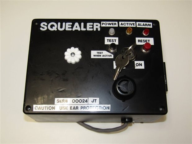

My solution to this problem was a device that was called "The Squealer"  Here is a picture of one of the first marketable prototype.
The Squealer was a duty cycle monitor that would measure the amount of time the dental compressor was actively running and compressing air. The time could be set at installation from 1 second to 512 seconds. The controlling device was a "delay on make" timer that would start timing when power was applied and then close the contacts after the prescribed time. If the time limit was not exceeded the unit would reset and wait for the next compressor cycle where it would again time the cycle. If the compressor cycle ran longer than the preset limit the Squealer would emit a very loud 110 db siren. It was necessary for the siren to be very loud as many of these dental compressors were in utility rooms that are isolated from the clinic's staffed areas. You can see that the Squealer would catch a leak problem in the early stage of the failure well before and serious damage would be done. Roughly 50 of these devices were made in my shop and test marketed to the dentists in my service area. They worked well, at least at first, but there were problems as well.
The first problem that I had trying to market these beyond my own area was that they had to be tied into two 220 volt sources on the compressor that was being monitored. I needed a 220 volt source for the siren electronics and I needed to monitor the 220 volts that went to power the compressor head. Dental compressors from different manufacturers wire their machines differently and as such the Squealer would always require a technician capable of working with 220 volts to install them. The Squealer was not a turn key device that could be marketed to the dentist. Still every one of my dentists who had a Squealer were no longer in danger of loosing their compressor to a simple long term air leak and there were several over time who benefited from this protection. After a year of so in the field it was noticed that there was a second problem with the Squealer. I had mounted most of the units directly on the compressor. Over a years time the vibrations of the compressor had broken wires and caused components to break loose. This became enough of a problem that I went back to the drawing board and redesigned the Squealer.

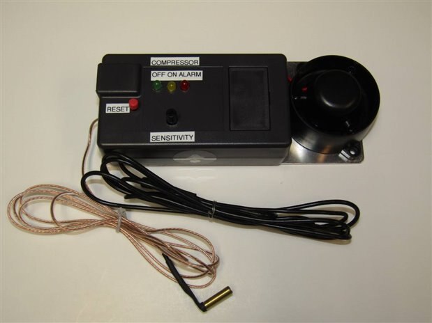

The Squealer III was an Arduino based unit that monitored the compressor duty cycle with a microphone. It was turn key as it could be installed by connecting it to a 9 volt wall wart, and putting the microphone in the vicinity of the compressor. The sensitivity of the microphone had to be adjusted so that it detected only the difference between normal utility room ambient noise and the noise of the compressor running. The time limit was programmable with dip switches under one of the covers of the case. I made 5 of these units and test marketed 3 of them for a six month period to make sure there weren't any serious side effects or problems.
