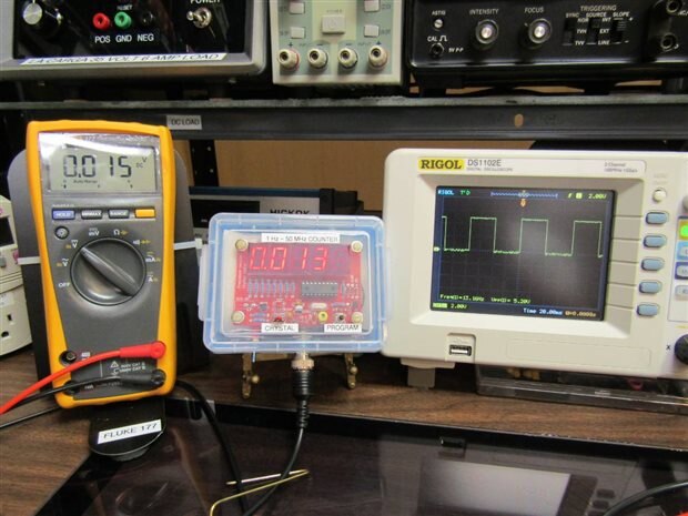

When something interesting like this TSL230 comes from a salvaged board I like to hook it up on a bread board and run a few experiments to get a physical feel for how the circuit works. The data sheet tells us that the TSL230 takes a light level on its photo diode and converts it to a pulsed output. Further the frequency of the pulsed output is dependent on the intensity of the light. The greater the intensity of the light level the higher the frequency of the output. The TSL230 also has programming options that allow the sensitivity of the input to be chosen between OFF, 1X, 10X, and 100X. The output is similarly programmable with the frequency output scaled with dividing by 1, 2, 10, and 100. It is noted in the data sheet that the unity selection produces an output that are pulses. The divide by 2, 10, and 100 selections are output as 50% duty cycle square waves.
For my experiment I have selected the 10X sensitivity level and a divide by 10 level for the frequency output. My light source will be a 6 volt miniature incandescent bulb. By controlling the voltage to the bulb we will be able to control the light level falling on the sensor. It will be important to shield the sensor from ambient light of the shop lights. I have found a black boot that will cover the TSL230 and adapt to the 6 volt bulb so that practically the only light getting to the sensor will come from the 6 volt bulb.
Here is a picture the bread board wired up and also a picture with the boot and bulb in place over the sensor
The circuit will be powered with the recommended 5 volts. We will adjust the voltage to the bulb with a variable power supply and the voltage will be monitored with a Fluke Multimeter. The output of the TSL230, itself, will be measured with an oscilloscope and a small frequency counter. You will probably recognize the frequency counter from one of my previous blogs.
This is the baseline with only 15 mV on the bulb and the output showing 13 Hz.
To properly illustrate here is a short video of the output of the experiment displayed on the oscilloscope and the frequency counter as the voltage, displayed on the Fluke, is increased to the 6 volt bulb. The Oscilloscope will initially show no movement as we are out of range on the low frequency end and, eventually, as we approach full brightness, the resolution will again be lost on the high frequency end. This is because I lack the hands necessary to change the horizontal time on the scope as needed. I have chosen a middle of the road setting for the time base. The frequency counter will better reflect the entire range.
