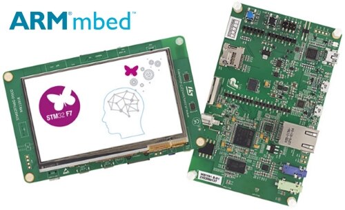

STMicroelectronics 32F746GDISCOVERY Discovery Kit helps discover STM32F7 Series of microcontrollers based on the ARM Cortex-M7 core. It allows for developing and sharing applications and can support audio/video player audio recorders and home intruder alarms. HMIs can also be designed, taking benefit of audio, video and color touchscreen features.
  • STM32F746NGH6 microcontroller featuring 1Mbytes of Flash memory and 340Kbytes of RAM, in BGA216 package
  • On-board ST-LINK/V2-1 supporting USB reenumeration capability
  • USB functions: virtual COM port, mass storage, debug port
  • 4.3" 480x272 color LCD-TFT with capacitive touchscreen
  • Camera connector
  • SAI audio codec
  • Audio line in and line out jack
  • Stereo speaker outputs
  • Two ST MEMS microphones
  • SPDIF RCA input connector
  • Two pushbuttons (user and reset)
  • 128-Mbit Quad-SPI Flash memory
  • 128-Mbit SDRAM (64 Mbits accessible)
  • Connector for microSD card
  • RF-EEPROM daughterboard connector
  • USB OTG HS with Micro-AB connectors
  • USB OTG FS with Micro-AB connectors
  • Ethernet connector compliant with IEEE-802.3-2002
  • Five power supply options:
    • ST LINK/V2-1
    • USB FS connector
    • USB HS connector
    • VIN from Arduino connector
    • External 5V from connector
  • Power supply output for external applications: 3.3V or 5V
  • Arduino Uno V3 connectors
  • Comprehensive free software including a variety of examples, part of STM32Cube package
