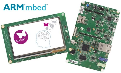

STMicroelectronics 32F746GDISCOVERY Discovery Kit helps discover STM32F7 Series of microcontrollers based on the ARM Cortex-M7 core. It allows for developing and sharing applications and can support audio/video player audio recorders and home intruder alarms. HMIs can also be designed, taking benefit of audio, video and color touchscreen features.
  • STM32F746NGH6 microcontroller featuring 1Mbytes of Flash memory and 340Kbytes of RAM, in BGA216 package
  • On-board ST-LINK/V2-1 supporting USB reenumeration capability
  • USB functions: virtual COM port, mass storage, debug port
  • 4.3" 480x272 color LCD-TFT with capacitive touchscreen
  • Camera connector
  • SAI audio codec
  • Audio line in and line out jack
  • Stereo speaker outputs
  • Two ST MEMS microphones
  • SPDIF RCA input connector
  • Two pushbuttons (user and reset)
  • 128-Mbit Quad-SPI Flash memory
  • 128-Mbit SDRAM (64 Mbits accessible)
  • Connector for microSD card
  • RF-EEPROM daughterboard connector
  • USB OTG HS with Micro-AB connectors
  • USB OTG FS with Micro-AB connectors
  • Ethernet connector compliant with IEEE-802.3-2002
  • Five power supply options:
    • ST LINK/V2-1
    • USB FS connector
    • USB HS connector
    • VIN from Arduino connector
    • External 5V from connector
  • Power supply output for external applications: 3.3V or 5V
  • Arduino Uno V3 connectors
  • Comprehensive free software including a variety of examples, part of STM32Cube package
In order to use this development board, please download latest IAR ARM version, since examples will not be able to compile first time, and may need some work to get it running !
