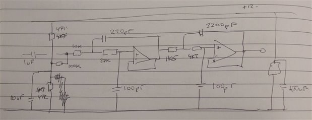

The H7 DAC needs a reconstruction filter - which looks like this:
The dual amplifier is an LM7322 and the filter is a 4th order Chebyschev wit a cut off at 100kHz, designed using TI's FilterCad programme.
I built it on Veroboard using a little bit of the nice TI sm -> DIP converter (Farnell 3125705).
The filter works fine and the performance of the sine wave generator isn't at all bad for a 12 bit DAC.
Filter response measured by Picoscope. A bit of fine tuning could recover that 0.5dB droop but it's not at all bad for 1% standard value resistors and 5% caps.
Here a some spectra measured using a Picoscope, sine wave frequencies 2k, 25k, 37k5, 99k, 100k:
This is about as bad as the spectrum gets, harmonic distortion is low at about -60dB (0.1%) but there are some nasty spuriae close to the fundamental and only about 50dB down.
The next plot shows the output of the DAC and the output of the filter at 99kHz (in case you were wondering if we needed the filter !):
