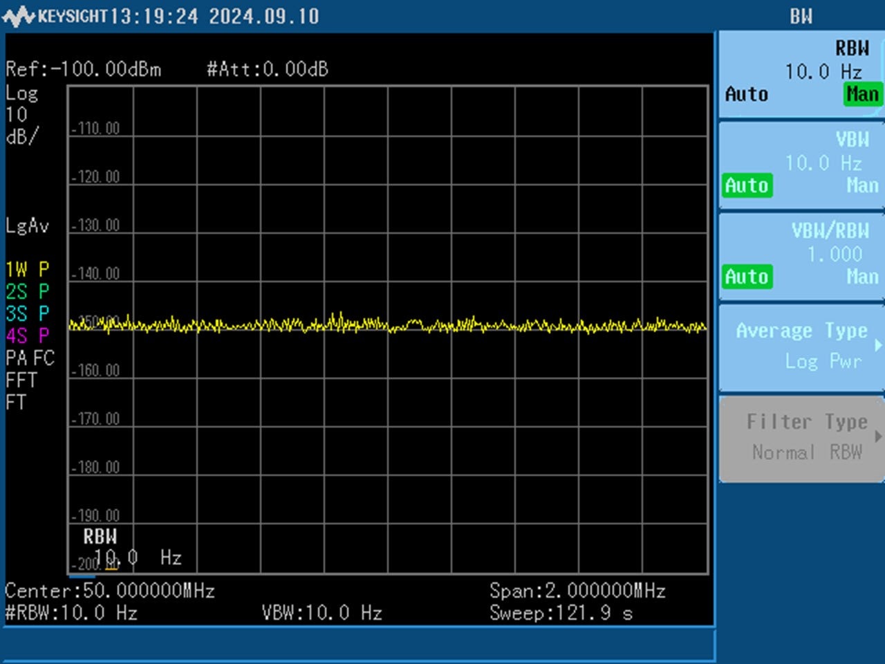

    shabaz over 2 years ago
    I got around to a few measurements of the DC-DC converter in this blog:  Building a Low-Cost Low-Noise Negative- or Positive-Rail Power Supply   a couple of months back.
    I achieved ballpark 160 uV (I made an RMS measurement so not ideal). Anything past 10 MHz or so is externally coupled noise, not part of the circuit under test.
    I attached the output using semi-rigid coax to a spectrum analyzer too (the measurement is in dBm and not a like-for-like comparison without some maths), and with very small RBW, just to confirm that there's indeed nothing in the spectrum there:
    From the spectrum visible in the 'scope screenshot, a better LDO would make a significant difference for that project. I used a TLV7401 LDO because it was low-cost.
    Hopefully one day I'll try a different LDO with it. But it is not fun winding transformers.
