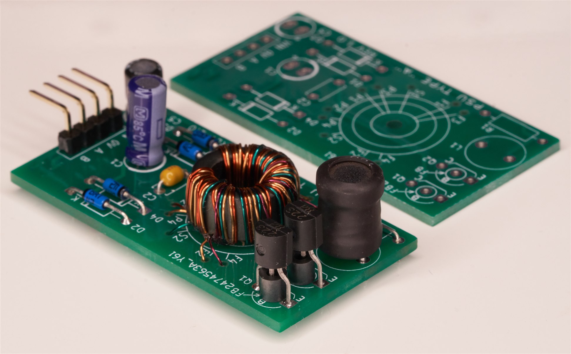

For flexibility, the design described in this blog post can be configured for three different modes: either as a positive output supply, a negative output supply, or as a fully isolated output. There are shorting pads on the underside of the board to select any of these modes with a blob of solder. The shorting pads are labeled S1 to S6 in the board render below:
Furthermore, there is space on the underside to solder on an optional voltage regulator for even lower noise and stable output. The project is through-hole (since every component used has jellybean status, and it’s already fairly compact) unless you require the optional on-board voltage regulator, which is surface mount.

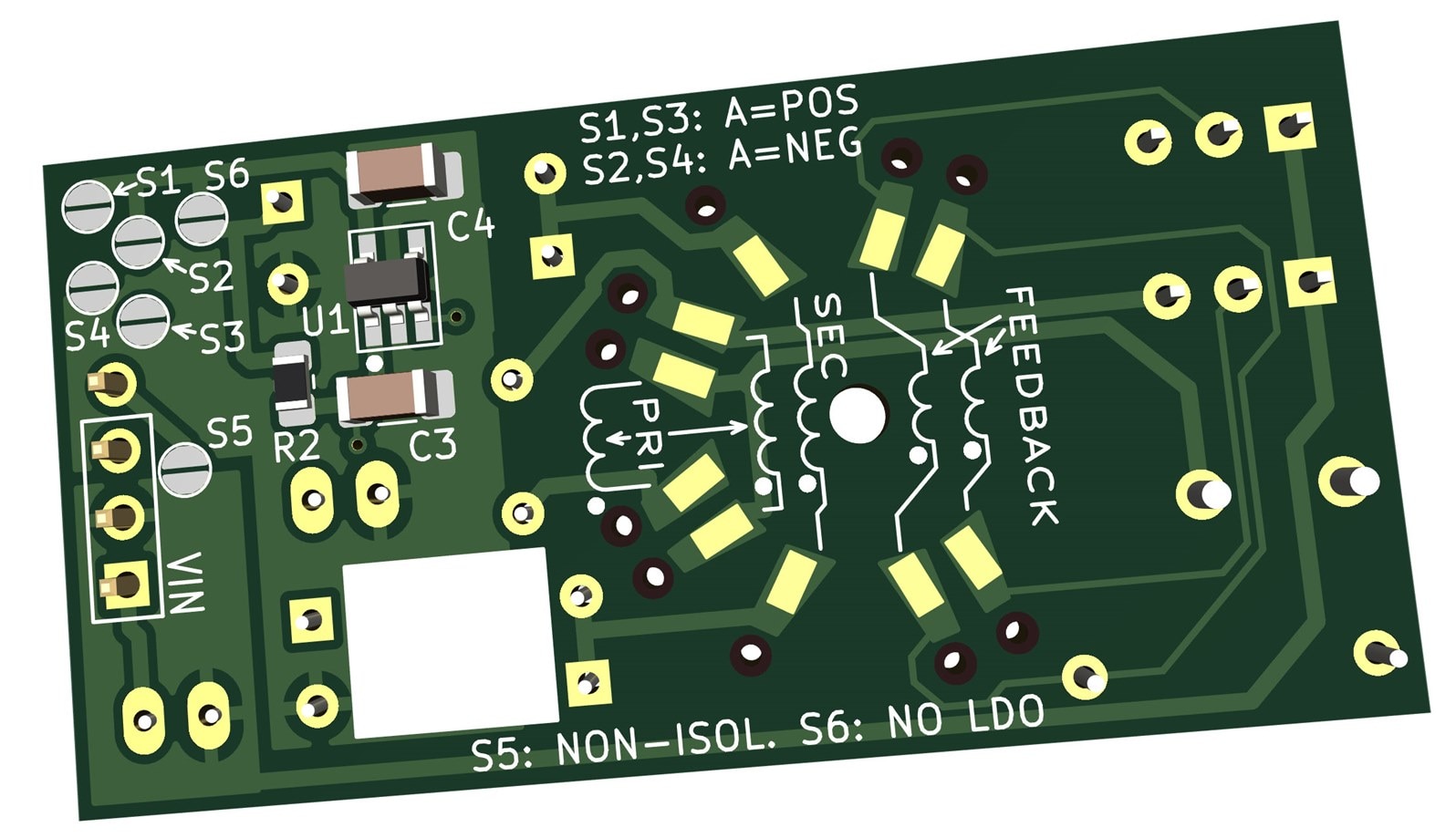

The entire circuit is shown below. Everything on the left forms the oscillator, where the two primary coils (with connections labeled P1-P2 and P3-P4) are responsible for the two halves of the sinewave cycle and are driven alternatively by the two transistors. C2 can be adjusted to determine the frequency of oscillation.
The dashed-box portion of the circuit is the optional voltage regulator. If this is not needed, then all the surface-mount components (R2, U1, C3, C4) can be omitted, and the pads labeled S6 (LDO_BYPASS) can be shorted with a blob of solder. The other pads labeled S1 to S5 can be optionally shorted to configure whether isolated output is required or non-isolated with the desired output polarity.
For example, if a regulated, non-isolated, negative output supply is needed, then S2, S4, and S5 must be shorted, and the negative output will appear on the third pin, which is labeled VA (the fourth pin, which is labeled VB, is only used in isolated output mode).

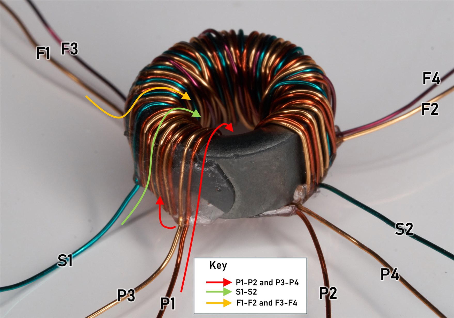

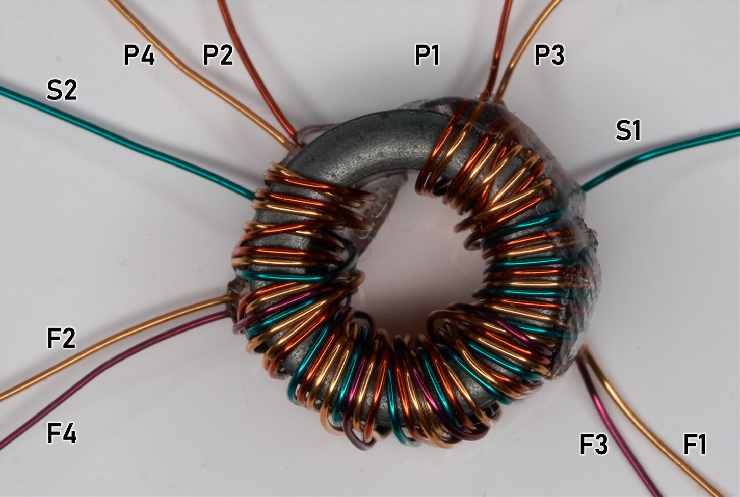

The photo here shows how the coil will be wound, but it is described in more detail below. In a nutshell, two wires (P1-P2 and P2-P3) are first wound (following the red arrow) until four turns have been wound. Then the wire labeled S1-S2 is wound as well (see the green arrow in the photo), so that now three wires are being simultaneously wound. Once S1-S2 is complete (12 windings according to the table above) then the P1-P2 and P3-P4 wires are wound for another four turns, so that they have a total of 4+12+4 windings, i.e., 20, which is in the table above.
Finally, two wires called F1-F2 and F3-F4 are wound for four turns. They are shown with the yellow arrow.
Wire Winding Procedure in More Detail

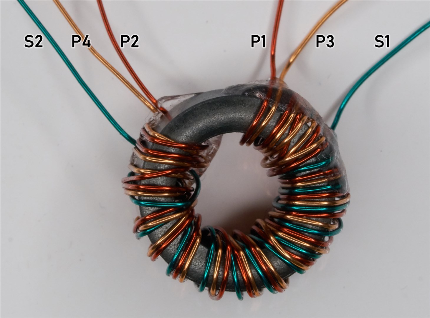

This isn’t difficult; it is a two-step procedure, and the photos can be used to see what is happening. I used 0.315 mm wire.
Step 1: Primary and Secondary Windings
Start with just the two Primary wires, hold them together in parallel, and wind them around the ferrite core for four turns. None of the windings need to be too neat, the wires can occasionally accidentally twist, so there’s no issue with that. Then add on the Secondary wire so that now you have three wires, and wind them all together for 12 more turns. Then wind just the two Primary wires for a further four turns. The end result will be three windings; the two Primary wires will have 20 turns (4+12+4), and the Secondary wire will have 12 turns. Secure the windings (e.g., with glue on the ends) and trim any excess wire so there is about 5 cm of wire free on each end.
By now, the winding should look like the photo above. If the wire is only available in one color, then different-colored permanent markers can be applied at the wire ends before winding. In the photo above, the two Primary wires are red and gold, and the Secondary wire is green.
In the photo above, the winding was started with wire ends P1 and P3, and 4 turns were wound and then wire end S1 was added, and then the windings proceeded as discussed earlier.
Step 2: Feedback Windings
Next, at the other end of the ferrite core, take the two Feedback wires and wind them for four turns. Wind them in the same direction as all the other wires, just effectively rotated to the other side of the toroid. As before, secure the ends with glue and trim if there is excess wire remaining.
In the photo above, the feedback windings were started at ends F1 and F3, and were wound in the same direction as P1, P3, and S1. That’s it; the transformer windings are complete!

Assembling the Circuit
The transformer construction was nine-tenths of the assembly effort. Now, the remainder is easy. One thing not to forget (it is marked on the PCB silkscreen as a reminder) is the ferrite beads that the transistors are sitting on.. that helped reduce some RF emissions as was discovered in an earlier blog post.
Initially, I didn’t solder the voltage regulator nor the bulk capacitor C1, so that I could obtain ‘scope traces of the partial circuit, and then I added C1 and measured the output to ensure it was below 5.5V because that’s the input voltage limit for the voltage regulator and I didn’t want to damage it.
The photo here shows the final assembled board underside, with the regulator and its associated components.
When soldering the transformer, all that needs to be done is to thread the transformer through the holes, crop the wires, and then heat the ends with a blob of molten solder to remove the enamel. Then, the wires are folded onto the board and soldered. The reason for the pads being this way is that I figured it could be easier for prototyping since the transformer can now easily be removed, rewound, and re-soldered.
The shorting links labeled S2 and S4 have been bridged with solder in the photo above, which means that the third pin outputs a negative voltage.

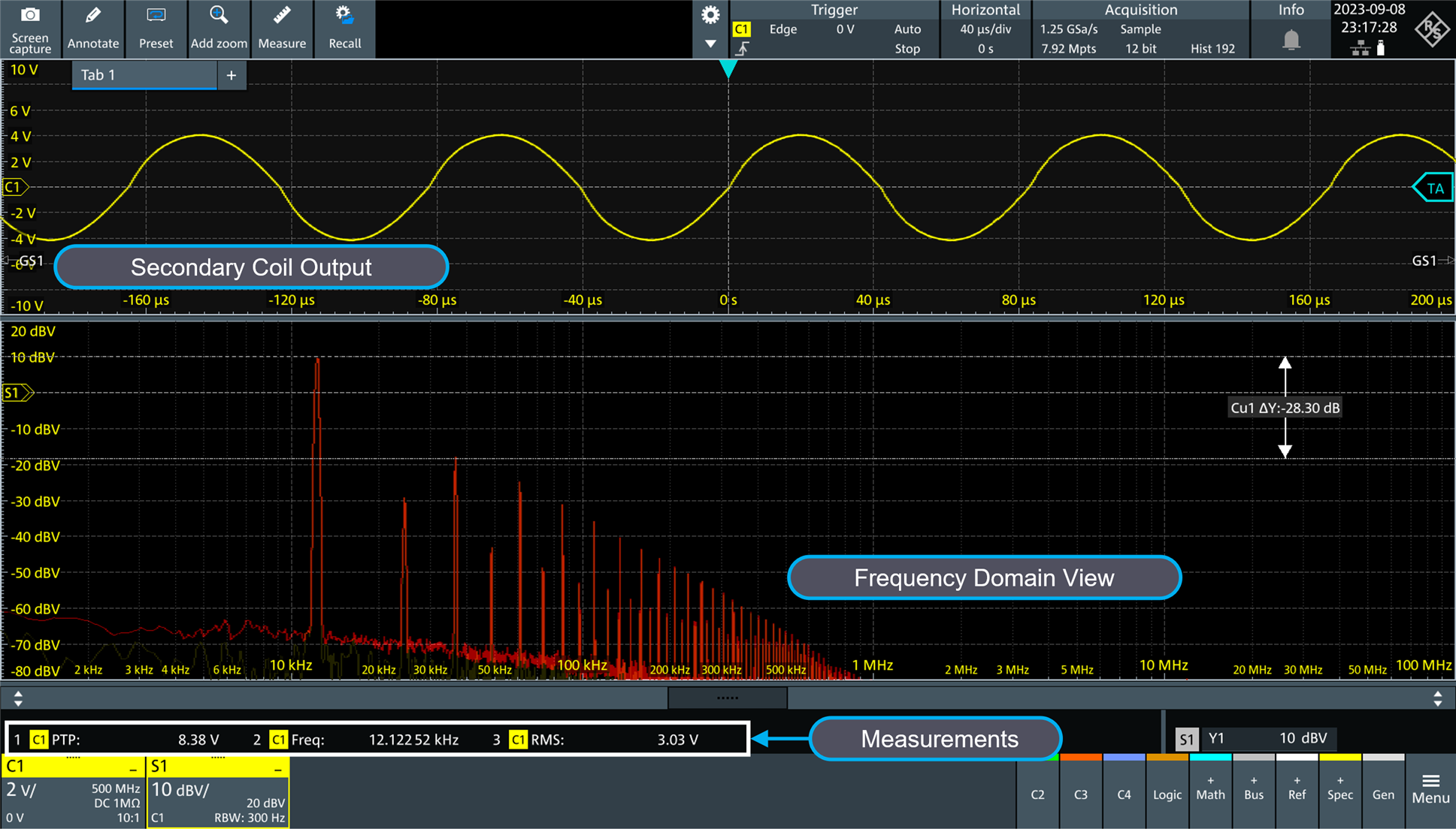

AC Output from the Transformer

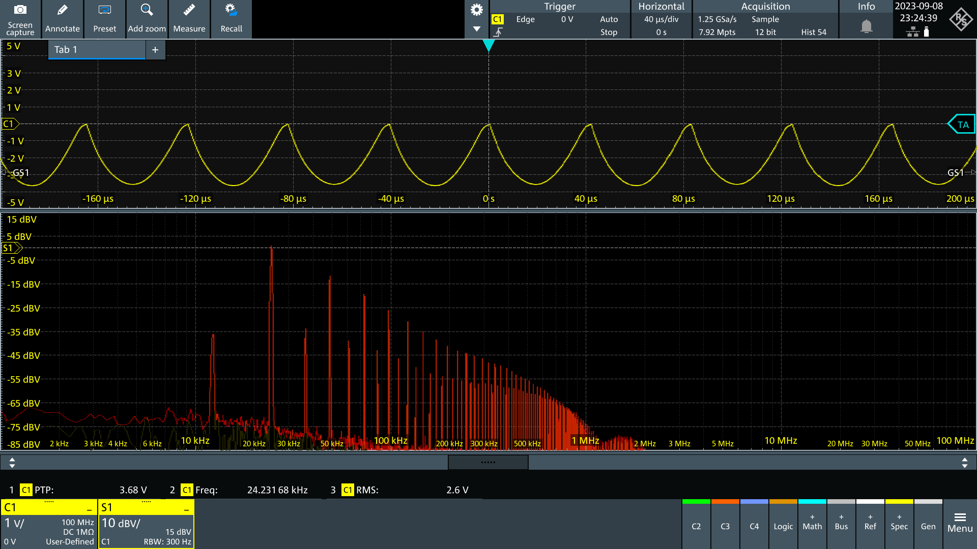

For an initial test, I powered the circuit from 5V and had no load on the output. The current consumption was about 20 mA. The ‘scope screenshot below shows the output probed on the secondary winding. As you can see, it’s an “almost” sinewave. There are harmonics, and it was possible to reduce their amplitude slightly with adjustments to the operating frequency of the circuit, but it can sometimes be better to have slightly higher amplitude harmonics, provided that the frequency is lower than smaller amplitude harmonics at a higher frequency. In any case, I was OK with the output for now because it will change slightly anyway when there is a load.
The spectrum view shows that the third harmonic is the highest, but it is still about 28 dB lower than the fundamental, which is pretty good!
Also, the frequency domain view shows that there’s not much output beyond 1 MHz, which is promising for subsequently adding a voltage regulator and removing a lot of noise.

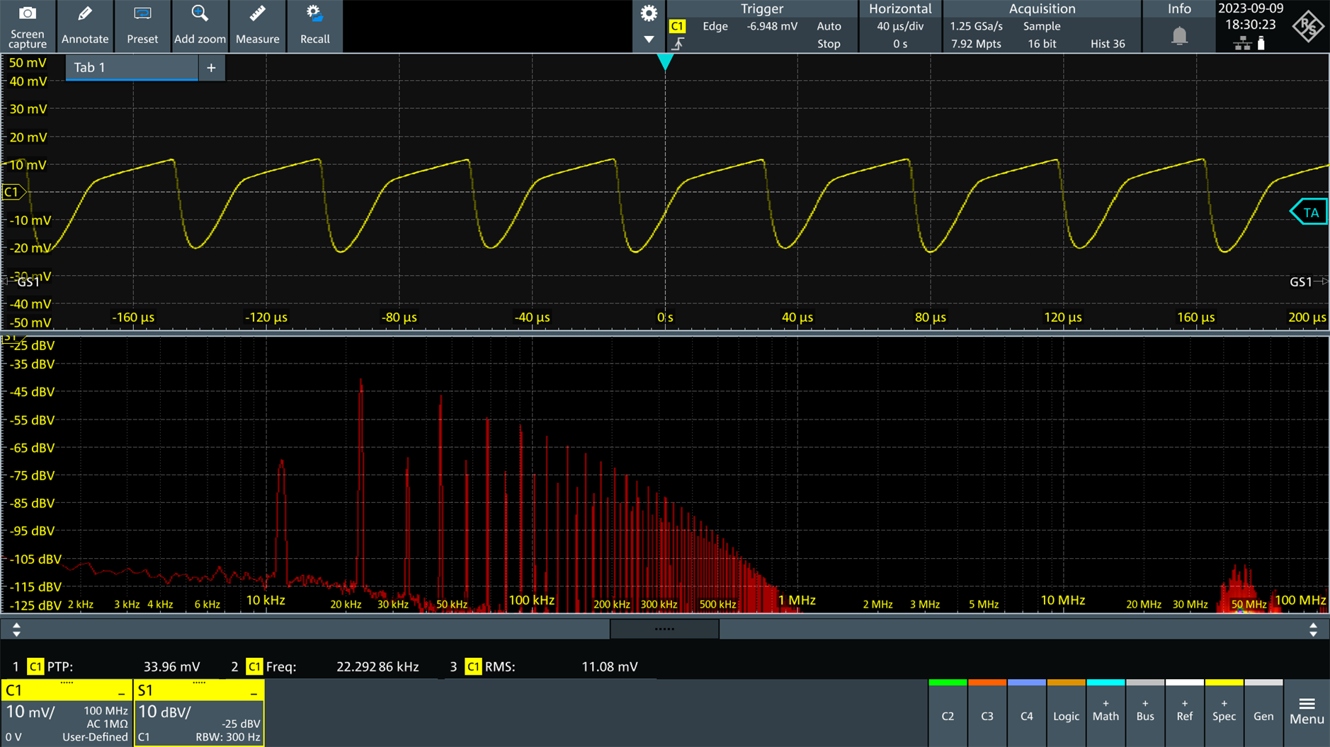

Rectified Output at 5V Input
The screenshot below shows the rectified output without any output capacitor attached. Again, the input voltage was 5V to the circuit. The rectification looks “upside-down” simply because I wanted to create a negative rail, and I connected the ‘scope probe accordingly. The rectified output was 2.6 Vrms (see the measurements displayed just below the spectrum view on the screenshot). The spectrum view reveals some output beyond 1 MHz, which I assumed was not good because that would be more difficult to remove from the final output from the circuit.
The next screenshot shows the rectified output when there is a 220-ohm load present. The measurement at the bottom of the screenshot shows that the output is now 2.26 Vrms.

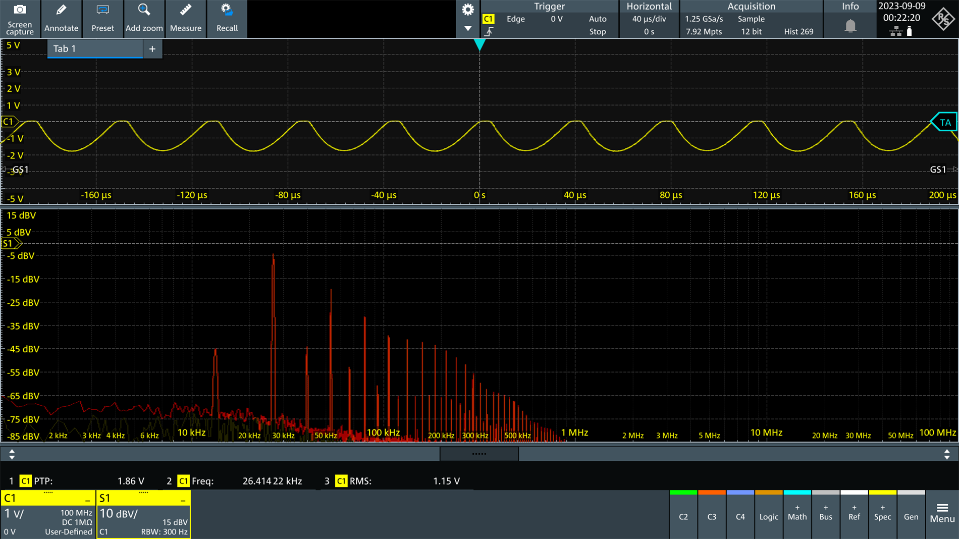

Here’s the scope view when the source voltage is set to 3V. There is no load present. The output is 1.41V RMS.
The screenshot below shows what happens when a 220-ohm load is applied. The output reduces to 1.15V RMS.

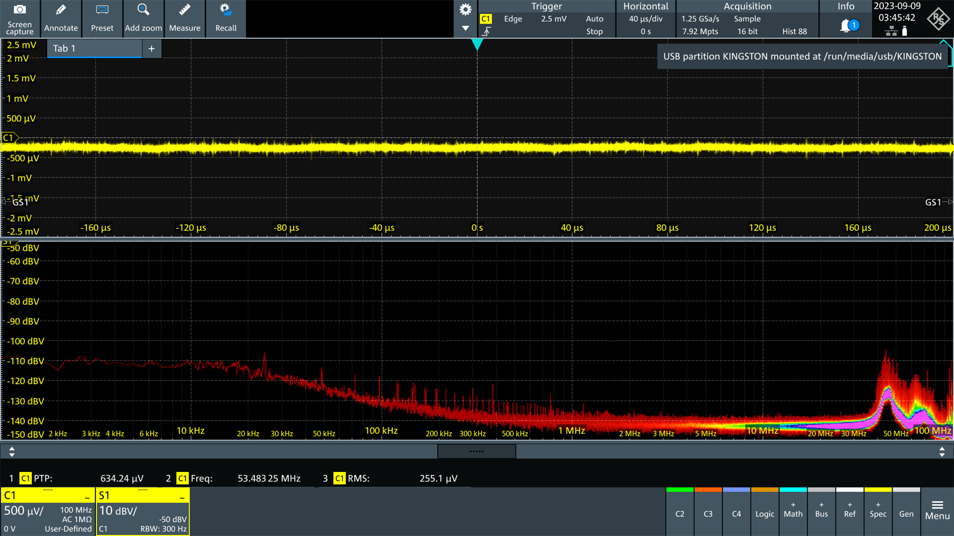

Output After Bulk Capacitor Ripple Reduction
Once capacitor C1 was added to the circuit (but no voltage regulator), the output was observed, this time with the ‘scope set to AC coupling. This was with no power applied, so I could see what noise was present without running the test:
Next, with 5V power applied. the screenshot below shows the result with no load. Not much difference!
With a 220-ohm load, the result is shown below. All the noise (which of course is primarily harmonics) tails off beyond 1 MHz (the bit of red at around 50 MHz is not related since it was present even when powered off).

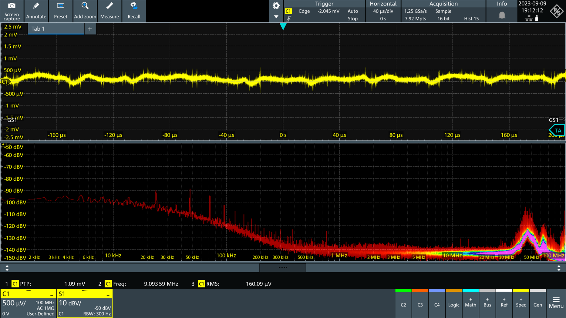

Regulated Output with 5V Input

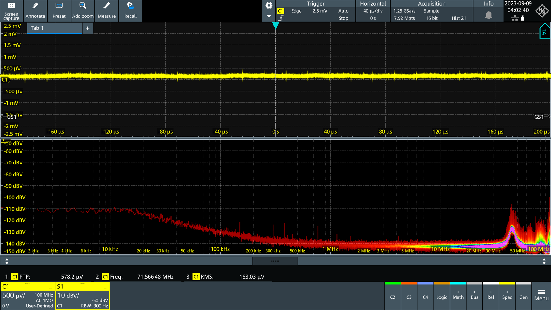

With a TLV7401 regulator soldered on, a -1V rail was expected. Here is what the output looked like (‘scope set to AC coupling), with a 220-ohm load:
According to the measurement at the bottom of the ‘scope display shown above, that’s 160 uV RMS, with a 100 MHz bandwidth, but the actual noise will be lower since there is some noise from the testbed that I couldn’t get rid of.
That’s pretty reasonable, considering that just about the cheapest parts have been used! Replacing the voltage regulator with the more expensive TPS7A20 would make quite a difference, perhaps. However, with the circuit as-is, I’d be happy to use it for a negative rail for an op-amp.
