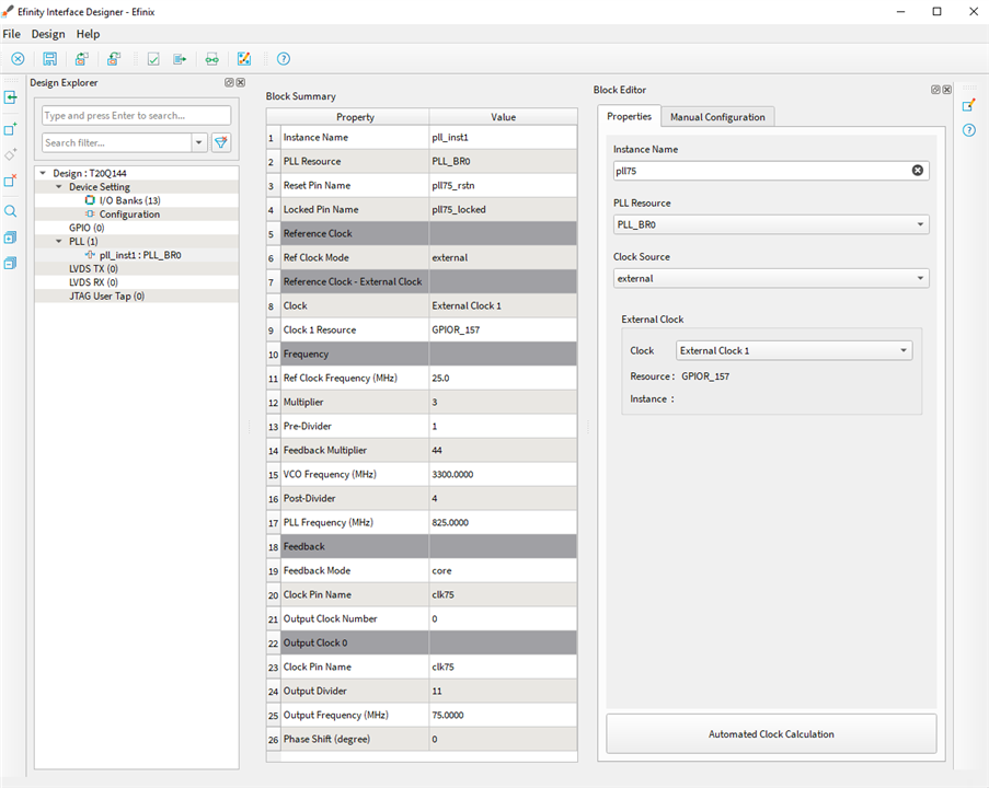

First you need to open the Interface Designer.
We’ll start with setting up the PLL. Since the 25MHz oscillator on the dev board is already connected to a particular clock input pin we must select a PLL which can use that pin and make sure it is correctly selected.
If you don’t want to use the default names, then you need to enter new ones.

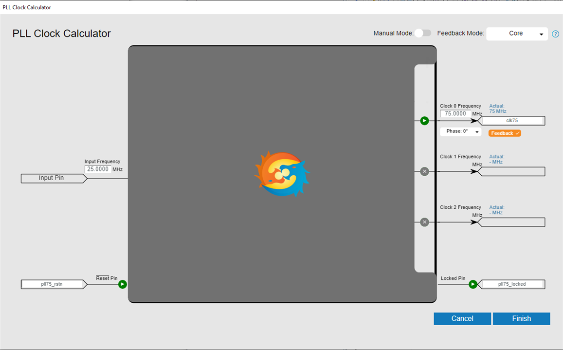

Now we can use the PLL automatic clock tool by clicking the lower button in the right-hand tab.
It’s quite simple to use. If you want to mess with the details, you can define all the PLL controls manually but for a single and simple clock that isn’t necessary.

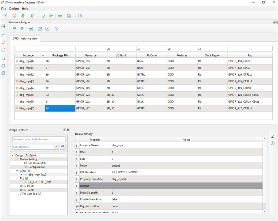

After the PLL we define the GPIOs.

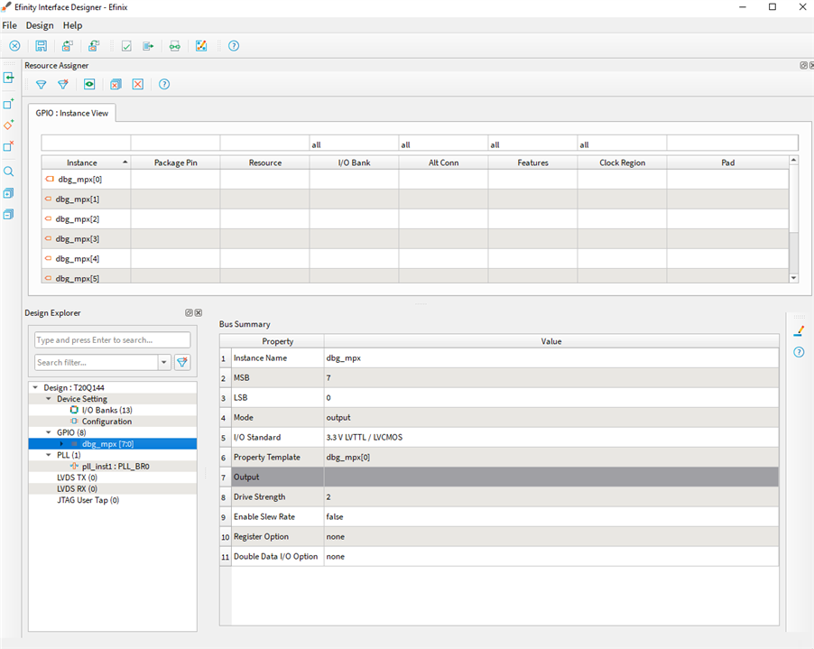

You click on things in the Design Explorer to add or delete GPIO features (like blocks for single pins or buses for groups of pins).
In the screenshot I’m setting up an 8-bit output port. Once the general features are sorted you must define the actual pins used in the top tab.
When you think you are done there is a useful check feature which will pick up[ most errors in the Interface design. (But not discrepancies between the Interface Design and the Core design.)
Once it all looks good at this level you can return to the main window and re-run the design.

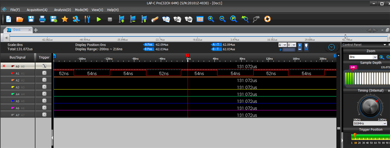

It runs as it is, and the logic analyser can show us the 75MHz clock divided by 8.
