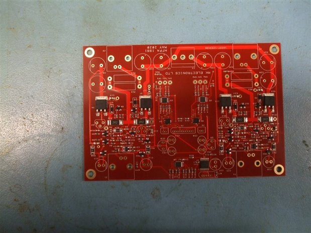

The idea of the power amp is that it can work effectively from DC to 2MHz with a 30V pk-pk output from 50 ohm source with no load. This causes some problems because it demands precision DC performance (which is easy to get form an integrated op amp but very hard to get any other way) and a high output voltage and slew rate with peak output current of 400mA - which is not available form op amps.
My solution is to use a precision op amp as the front end and a discrete transistor amplifier to do the heavy work. It worked OK in simulation but the real performance so far is not quite where I want it to be.
There seems to be quite a bit of interest in how people build stuff so I'm going to provide some pictures and explanation of how I do it.
The boards were designed using Easy PC and made by PCBCart in China. 5 boards cost me £135.40 (including the solder paste stencil) , they took about 10 days to get here, half of which was shipping time.
A board on the solder paste screen print machine.
The precision solder paste application system in action !

When I first powered up the board it was obvious that there was a problem - almost any disturbance, including touching the DMM probe on the output and it would burst into oscillation at about 700kHz and draw lots of current. I had set a 300mA current limit on the +/- 20V supply and it would pull this down to +/- 10V.
I had a bit of a re-think and some LT Spice fiddling and came up with some new component values.
This spice model has several component changes compared with the one I posted in May.
These changes did the business to the extent that it doesn't lock up and more or less behaves.
