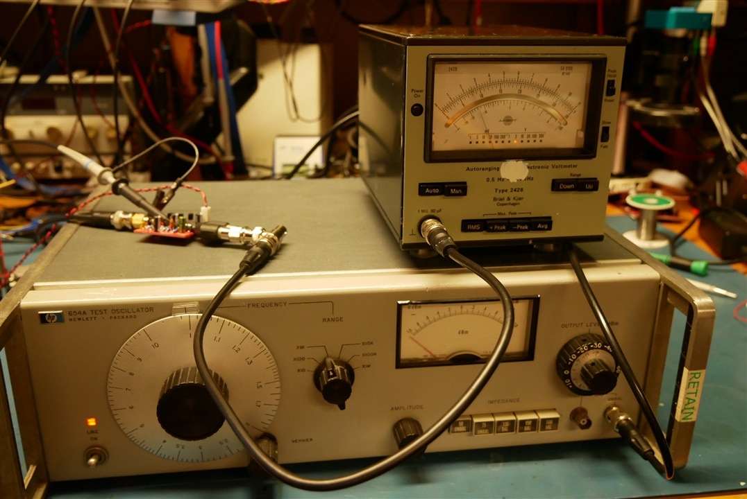

I measured it using the HP654A Test Oscillator which I have had for some time. It's a nice LF oscillator with good amplitude flatness and a 99dB range output attenuator with an additional +/- 1dB fine control of the oscillator output amplitude. The huge attenuator range is great for measuring amplifiers.
The downside of the 654A is its rather high distortion (approx 1% at 1kHz and worse above 1MHz). One day I might replace some of its insides (but not until all the magic smoke of the original parts is used up). You can still find the service manual on the web.
I measured the amplifier outputs with the B&K 2426 auto-ranging voltmeter. It's a recent acquisition from an auction and cost about £55. It needed a little attention to its switch contacts but is working nicely now.
The other tool used was the Picscope 6424E which I Road Tested some time ago. It's been replaced as my everyday scope by the R&S MXO4 but Pico keep poking me about their Picoscope7 software and I thought I should give it an outing.
The picture actually shows the K2 pre-amp but the tests set up was mostly the same.
(I do wish that people wouldn't deface beautiful instruments with silly calibration stickers - this one is so well stuck that I think removing it will bring the lettering off too.)

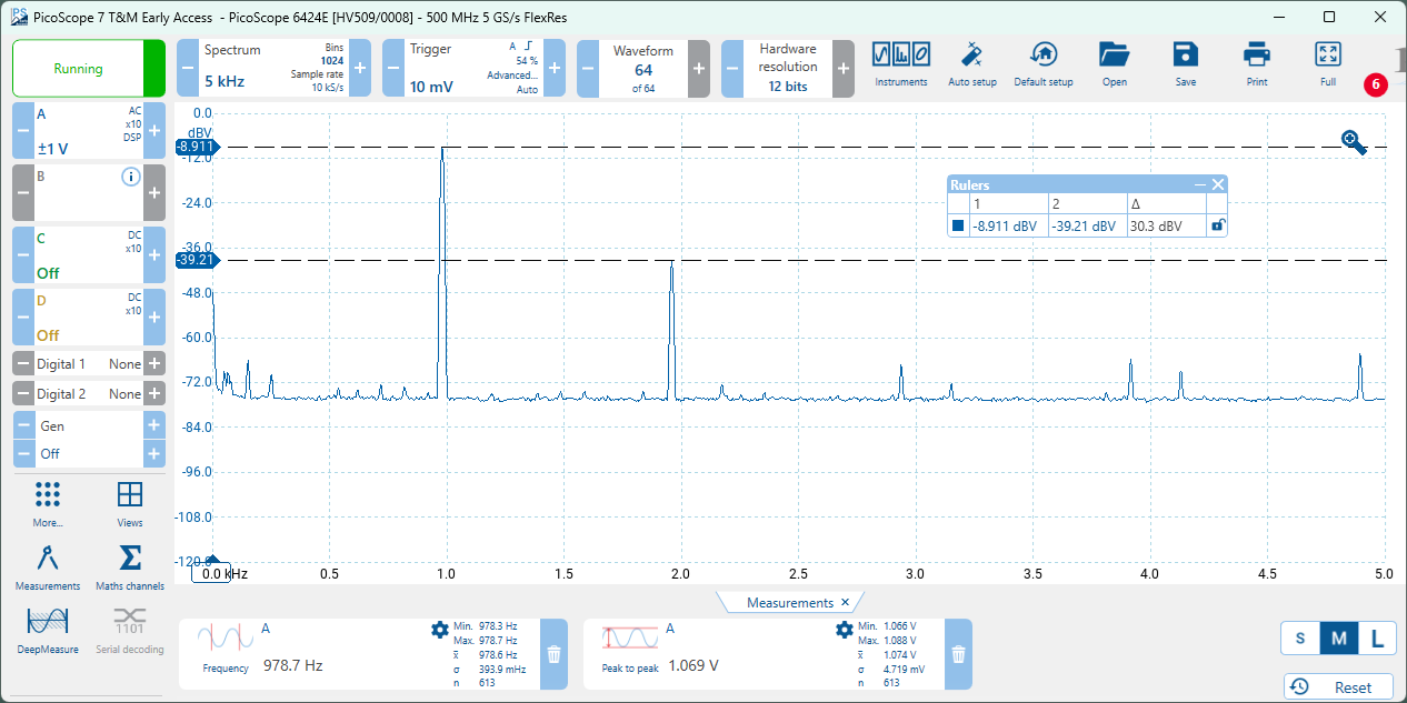

K1 pre-amp Distortion

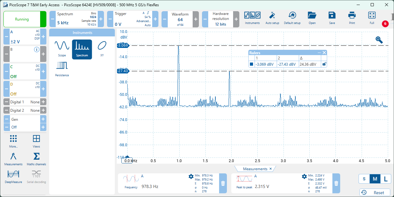

I used the Picoscope to measure the distortion. The K1 distortion is so bad that the HP654A was quite good enough as the signal generator. All measurements were made at 1kHz with an 8V supply.
Distortion performance of K1 pre-amp 1V p-p output
Distortion performance of K1 pre-amp 2V p-p output
The distortion performance is pretty grim - 24.36dB is about 6%.

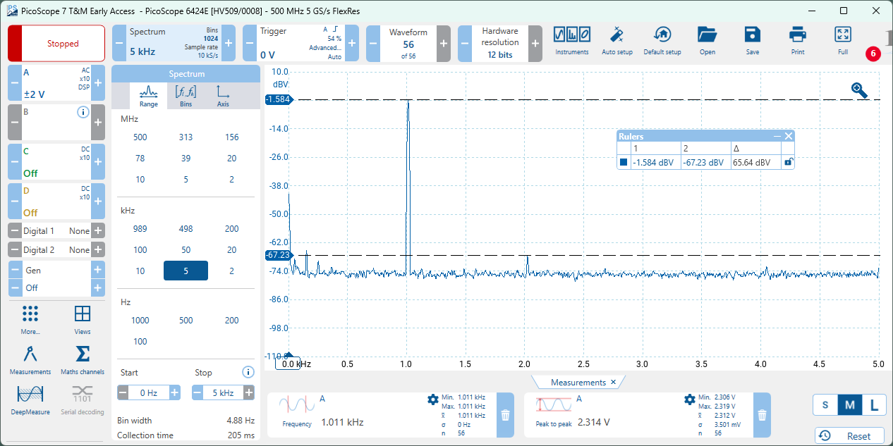

The HP signal generator is not anywhere near good enough to measure the distortion of the K2 pre-amp so I used a Neutrik A1 Audio Tester as the signal generator. It can measure distortion as well but I stuck with the Picoscope for a more direct comparison with the K1.
Neutrik A1 Audio Tester, 1kHz distortion approx 0.004%.(-88dB)
K1 pre-amp distortion 2.35Vp-p out, 1kHz, 8V supply = -65.6dB = 0.05%

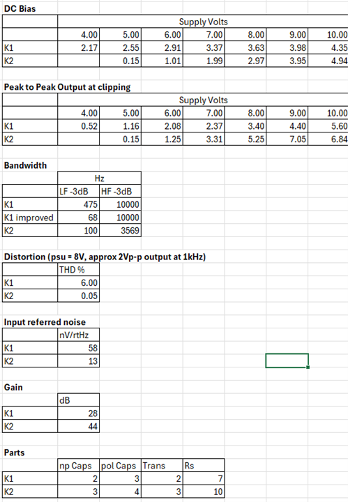

Pre-amps Performance Data
Pre-amps - summary
The K2 pre-amp uses a few more parts but massively out-performs the K1 in all respects other than low voltage working. If that's a problem the design could be tweaked a little to optimise the DC bias of the K2 for a different voltage range.

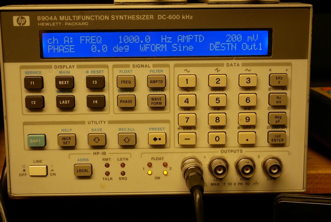

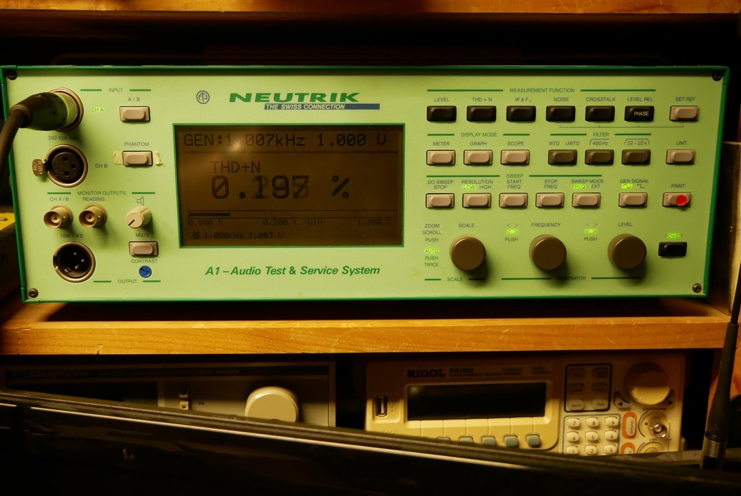

The distortion of the power amplifier is a bit too low to be measured on a scope so I used the Neutrik A1 to measure distortion but an HP8904A signal generator because it has much easier level adjustment and it hadn't had an outing for a while. It has a nice new blue display because the old grey one had almost no contrast any more.
HP8904A signal generator with replacement LCD display
With an 8V supply the best output power I could get just before clipping was about 1.357V into 8R  = 230mW

The distortion at 1V RMS out (8V supply 1kHz) was 0.09% and after D2 was shorted rose to 0.19%.

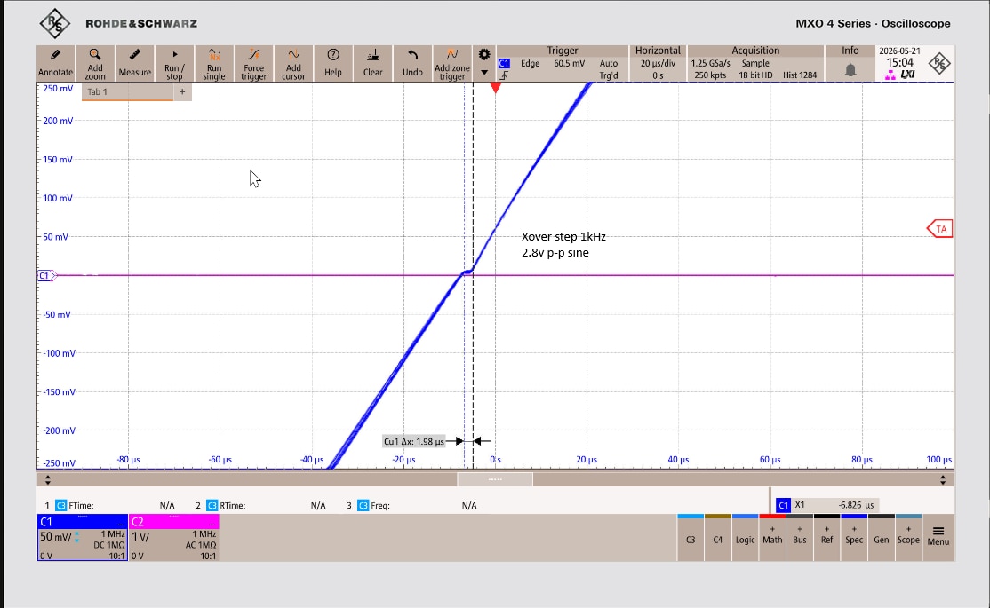

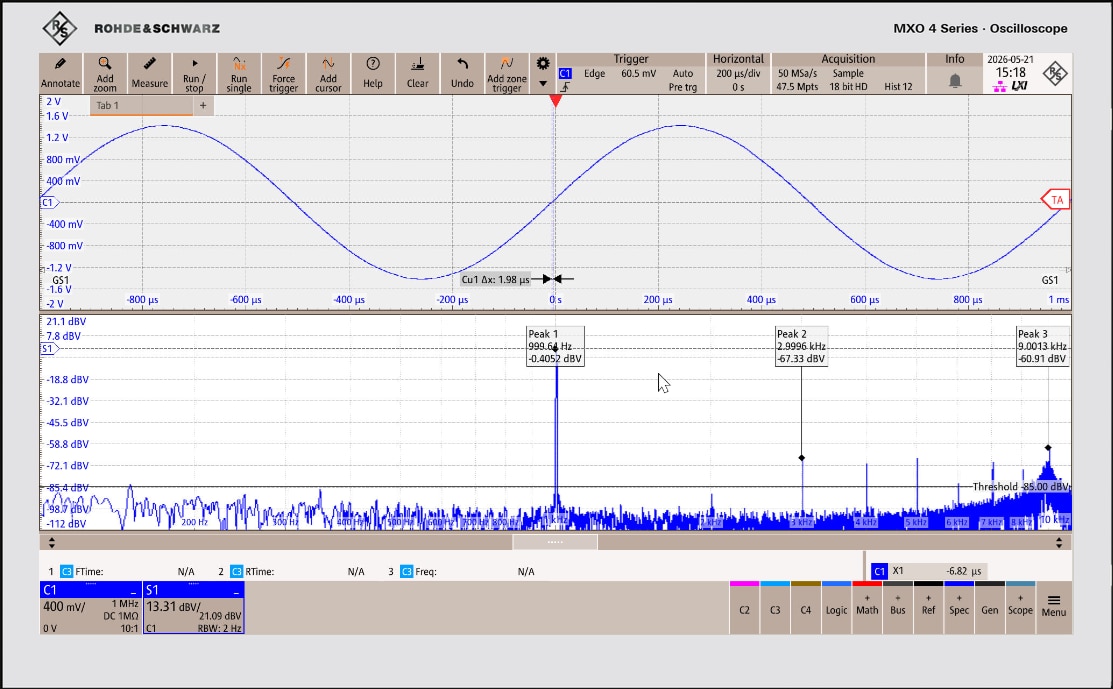

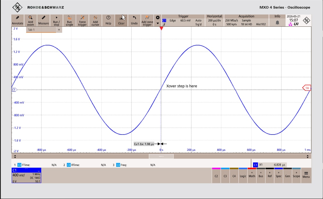

The distortion added by shorting one of the diodes is crossover distortion because there is a small period where one output transistor turns off but the other hasn't turned on. You can see this on a scope if you look hard:
single diode X over distortion
same signal and same cursors to put the crossover step into scale
approx 1V RMS output with spectrum

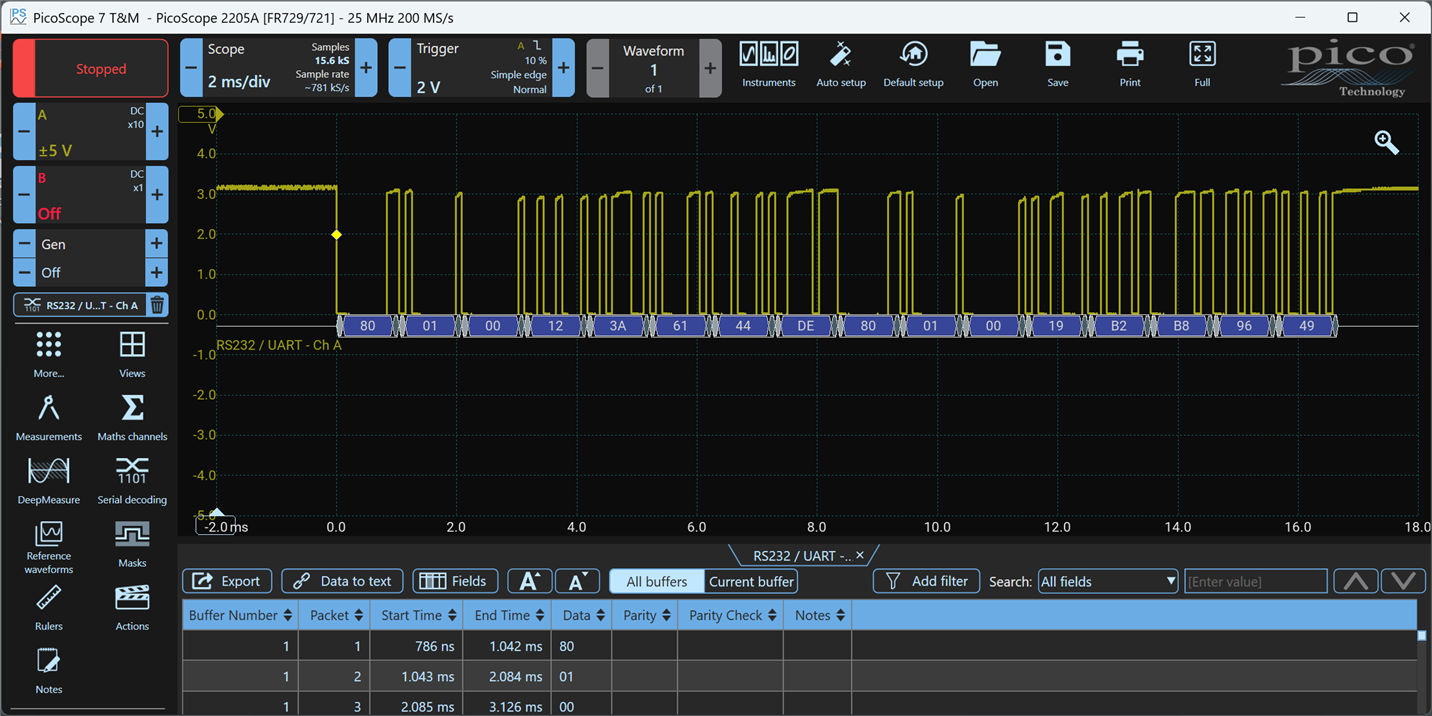

    By coincidence I downloaded the Pico software too today, and was using it (to troubleshoot a UART issue). I have the bottom-of-the-range 2000 series, but it's still so convenient for working anywhere with a laptop.
