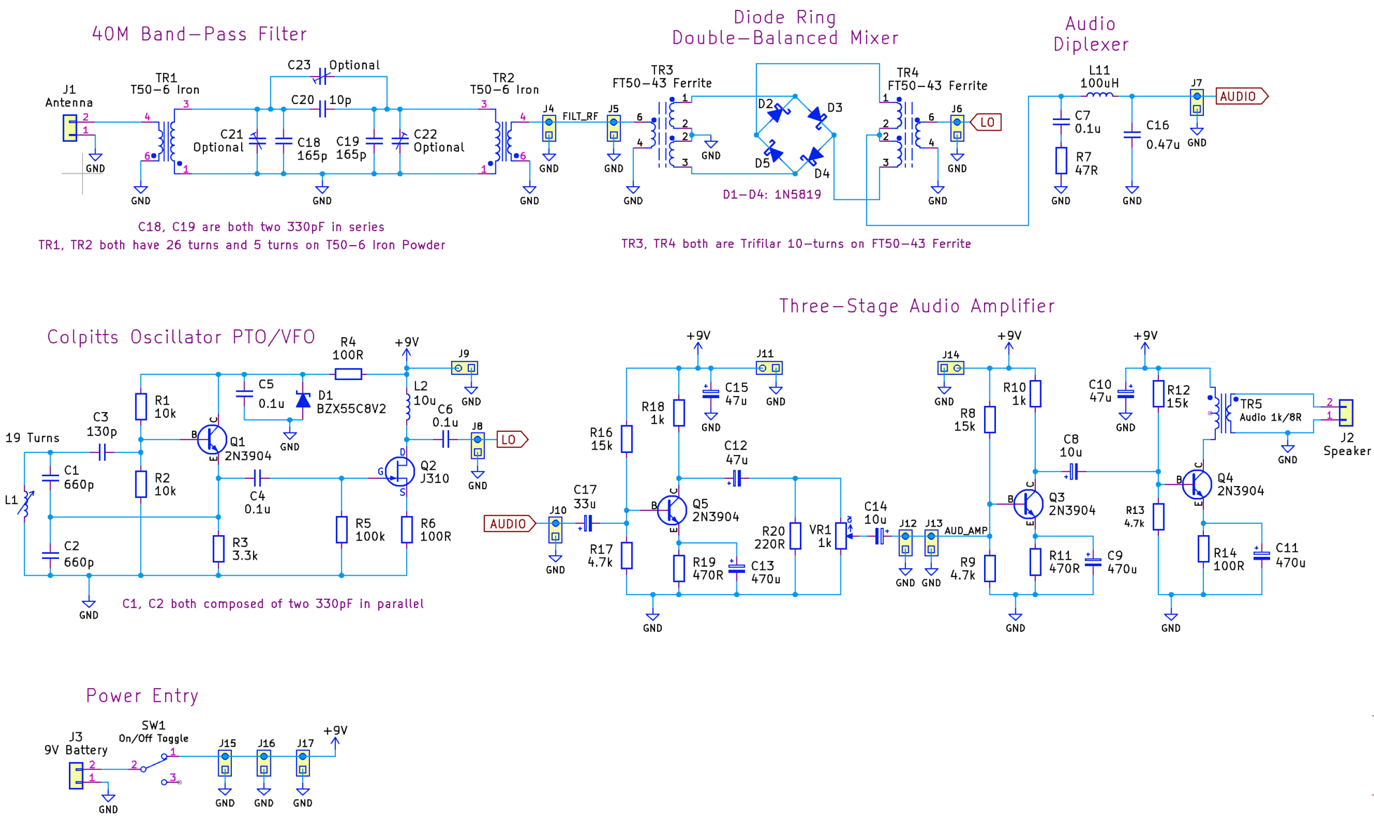

Circuit Diagram
Consult the GitHub repo for the latest circuit diagram in case it ever changes, but the first revision circuit is reproduced here.

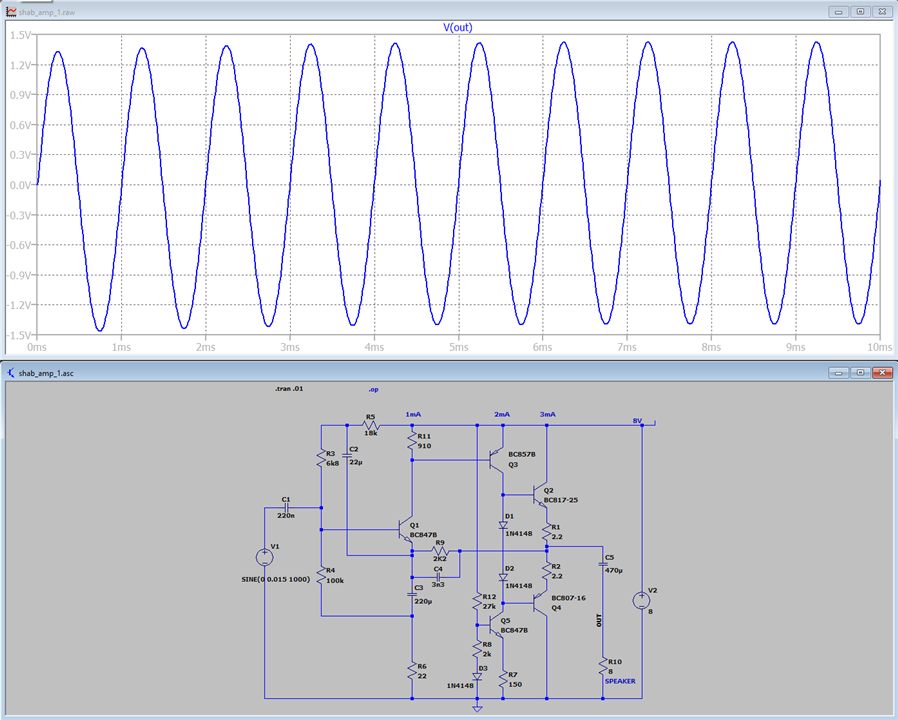

The entire audio amplifier circuit stinks. To be fair, it was never intended to be of good quality; as I understand, it was just a quick hack by someone, intended to be improved at a later date, and I'm guessing it was also deliberately intended to encourage people to experiment and improve upon the almost-minimal-viable circuit. The amplifier uses a cheap transformer in the third stage (the first stage is labelled Audio Preamp in the block diagram, and the second and third stages together are labelled Audio Amp), as found in 1970’s pocket transistor radios. These transformers are available from AliExpress.
If it were me, personally, I’d replace the circuit with an audio amplifier integrated circuit (IC), but that’s probably not in the spirit of the design of this radio, since I believe it was deliberately intended to be entirely discrete. Nevertheless, you’ll notice that the PCB can be snapped into pieces, or traces can be cut, and perforated prototyping boards can be piggy-backed on top, with custom modules if desired. I think it would be worth doing that for the audio amplifier one day, but I wanted to build the circuit as it stands for now.

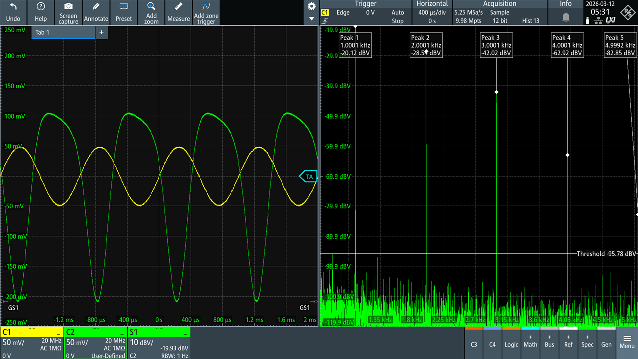

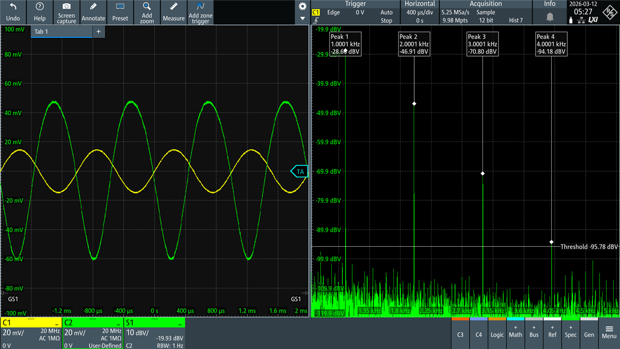

The screenshot below shows the input 1 kHz signal in yellow, and the output in green. In this screenshot, the input voltage is 30 mV peak-to-peak (p-p) and the output is about 105 mV p-p. That’s not a lot of power! Enough to be audible in a very quiet room, perhaps.
Why did I pick 30 mV p-p for the input? That’s simply because much higher than that, and the distortion gets worse. In reality, a lot of distortion isn’t a showstopper, because the amplifier is not intended for music; it’s for tones or speech.
Here’s what happens when the input is increased to 100 mV p-p; tons of distortion, but probably usable in a pinch; it's amazing what the ear can choose to ignore when listening to speech:
Incidentally, the spectrum views to the right of the screenshots show a span of 5 kHz. You can see the fundamental (1 kHz) and some of the harmonics.

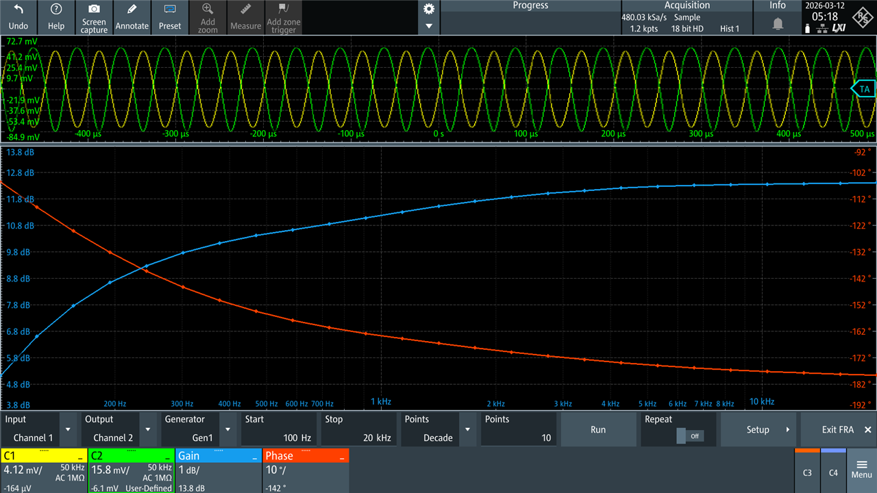

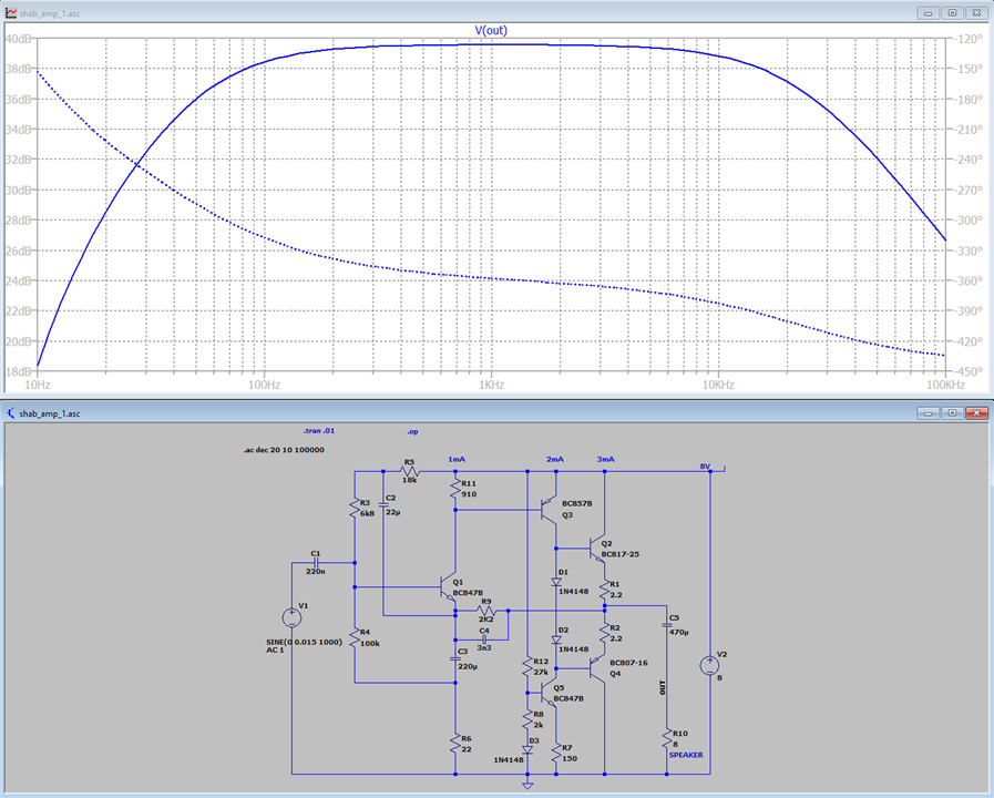

I decided to plot the frequency response of the amplifier third stage, for 100 Hz to 20 kHz (in reality we only really care for speech at about 300 Hz to 3 kHz I expect).

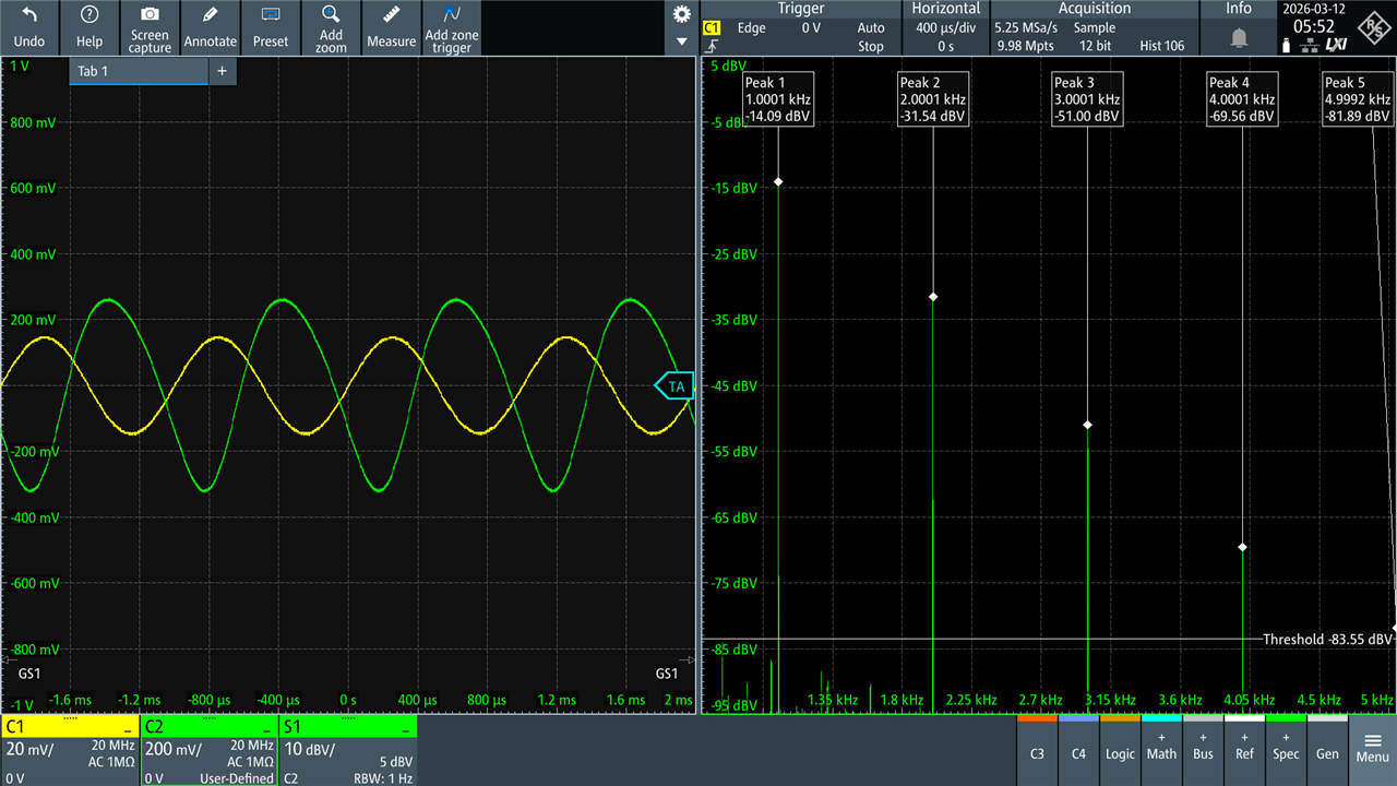

The screenshot below shows the result with a 64 ohm load and an input of 30 mV p-p. The yellow input is shown at 20 mV per division on the oscilloscope, and the green output is shown at 200 mV per division.

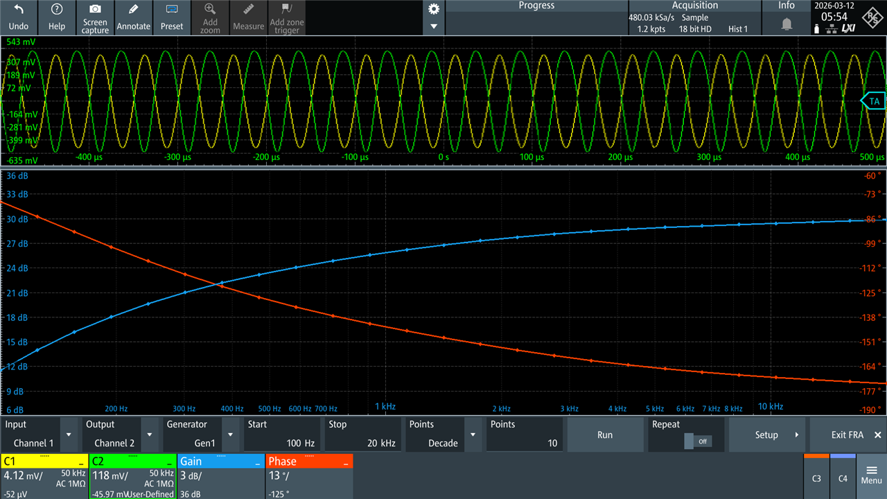

Just for completeness, here is the frequency response with the 64 ohm load:

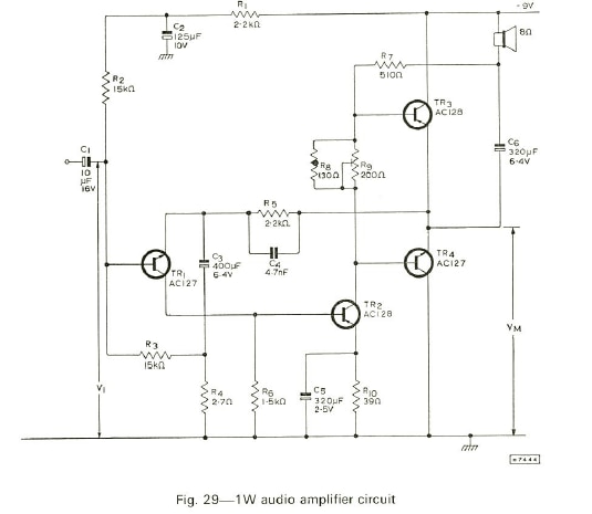

    Made a start - will try and make one on veroboard soon -  the design is mainly cribbed from
    Published in 1969.
    I'll change the transistors to the best fit TO92 types that I can find.

    if you want to stick with discretes I'll be happy to design a transformerless output amp for you.
    Nothing more fun than audio  - I think its because you can test the result with ears and no test gear.
    MK

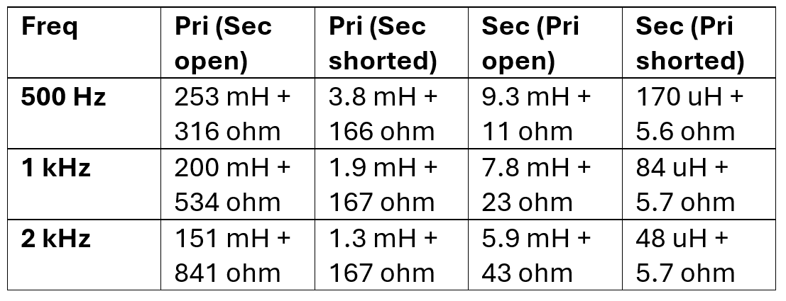

    For anyone curious about the transformer, it has about 89 ohm DC resistance at the primary, and 3.3 ohm on the secondary. I put some impedance measurements in the table below, but I’m not sure how useful they are, I don’t think there’s much value trying to improve this circuit much further, since it is based on an AliExpress transformer which could be very different when ordered a year later that the one I measured.
